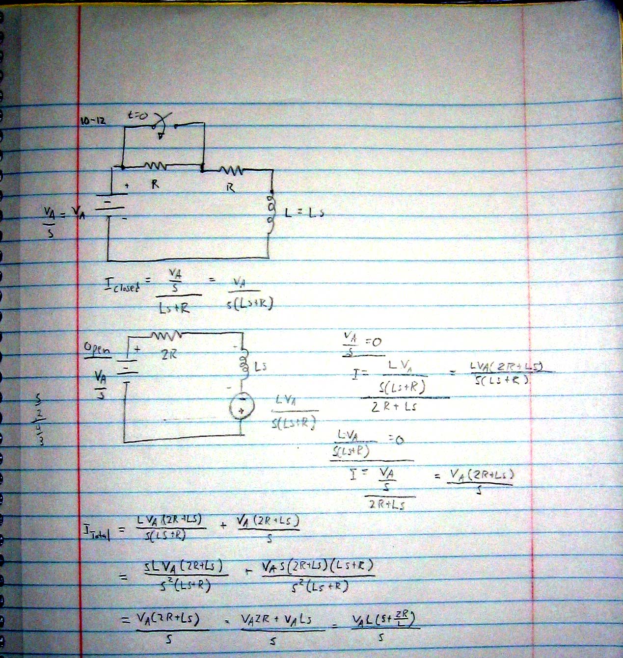

Am I doing this right? (s domain analysis)
SeanHatch
The switch in the following circuit has been close for a long time and is opened at t = 0. Transform the circuit into the s doman and solve for Isubl(s) and Isubl(t) in symbolic form.
I've only found Isubl(s) so far, and I want to see how I'm doing before I convert it back to the time domain. I hope my work is clear; I used the t < 0 circuit to find out the inductors initial current, then used superposition to find the final current.
How am I doing? Thanks alot.
