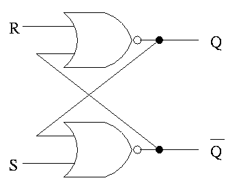

Do you have suggestion on how to model the SR latch in this boost converter? It looks like the SR latch can take the invalid state (S=1 R=1) since it has no mechanism to stop this. Is this a certain type of latch or something or is just this a standard SR NAND latch?
I think it is set dominate like this. Using it this way the timer can still pulse the FET on.
If set is dominate, that means the over current protection won't work. Plus in invalid state doesn't it depend on transistor properties (delay time/etc) which Q state it ends up at?
if set is dominate, that means the over current protection won't work.
i haven't studied what fires the timer, but yes when the timer is active the current limit will be off (i think)
plus in invalid state doesn't it depend on transistor properties (delay time/etc) which q state it ends up at?
if the set and reset were the same pulse that would be true, but they aren't.
