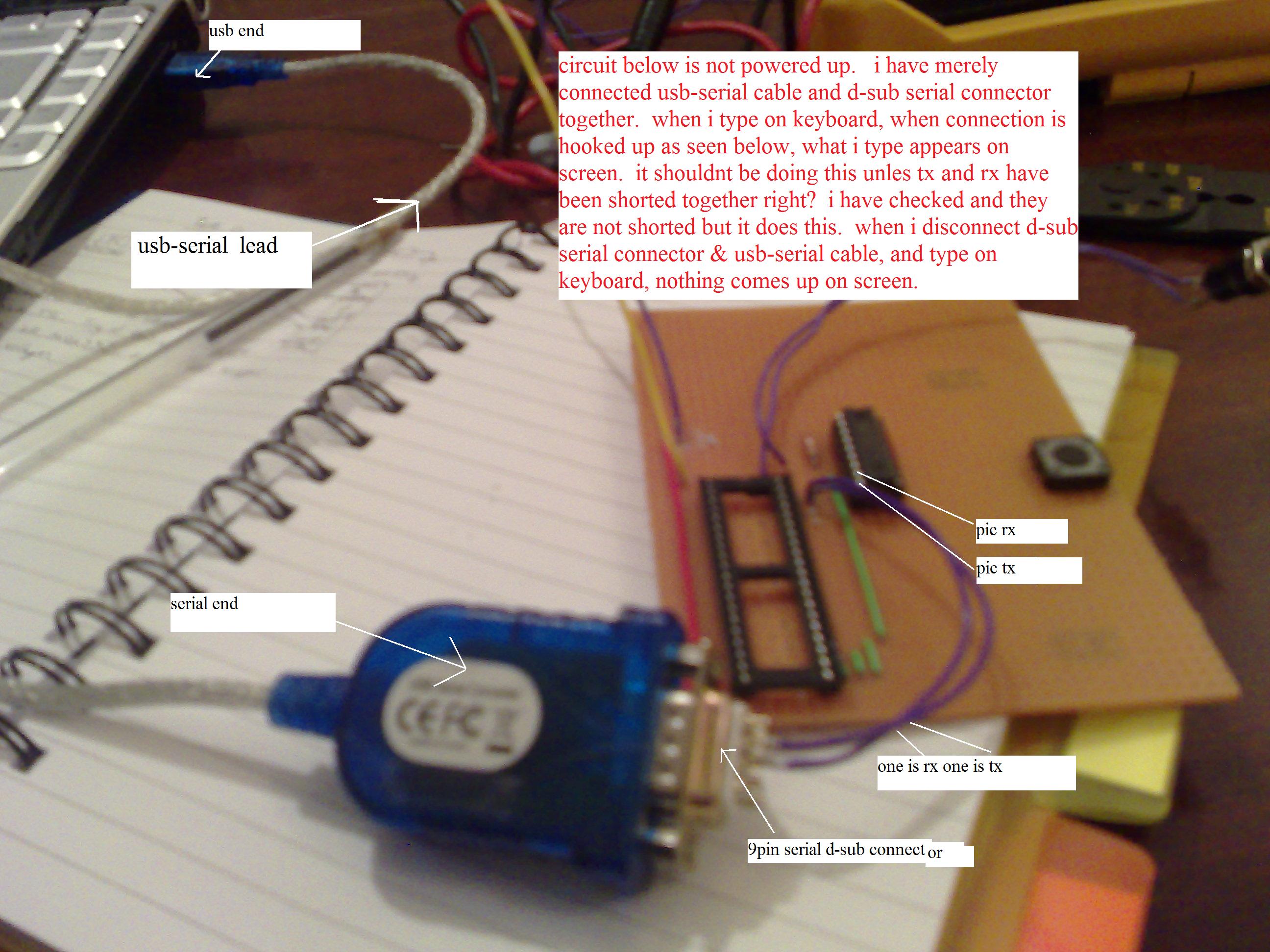

i connect my usb2serial lead to the usb of the laptop, a virtual com is created, and i am able to connect to it in hyper terminal. now here is the problem..
i was told that to test that hyper terminal and the lead is ok, short the tx and rx pins of the serial side of the serial-usb cable(pin 2&3).
then type something into the hyperterminal window. this means what u type is sent from the pc, from the USB end of the usb-serial cable, to the serial end and appears at the rx pin of the serial end. because rx and tx are shorted, whatever appears on rx appears on tx, therefore, the same signal is sent back along the USB-serial cable, and recieved at hypeterminal. it is looped or "echoed" back, and the characters appear on the screen. this works. when i un-short these pins and i type on the screen, no characters come up, which is normal, because hyperterm isnt recieving any data, right?
now, i connected the serial end of the USB-serial cable(pins rx and tx), to a 9pin serial d-sub to its corresponding rx and tx pins. i am ONLY using the rx and tx pins because i am not using any hardware flow control.
when i connect them, iv noticed when i type on the hyperterminal, the characters come up!! why is this? i thought ok, maybe my soldering is bad and i have shorted these pins, which is why it is being echoed back, i checked, but nothing. i have not shorted them. how comes what i type into the keyboard is being echoed back and displayed on the screen? note this is only when i plug in the 9pin serial d-sub connecter to the serial end of the serial-usb cable. does any body know what it could be??
i wil try and include a picture to explain this better
i have attatched a picture, to try and explain what i mean. thanks

thanks for ur help but it didnt work. i tried a way of finding problem, what i did was..
as u can see, the serial d-sub connector has 2sides. one side with female holes, and the other sides with pins sticking out which have solderd the wire to which lead to my circuit.
when i test using the multimeter with the beep thing, the tx and rx pins on the d sub serial connecter are not shorted.
what i did was, i put a wire in the TX hole of the d-sub, and the other end of the wire i tied to +5V. this now means +5V being supplied to TX pin of female hole of serial d-sub connector.
i then took out multimeter, and put one strobe on ground, and the other strobe on the TX pin of the serial d-sub connector, but on the OTHER side, if u get what i mean.. on the side where i solderd a wire onto it which leads ot my circuit. the multimeter read 5V. that is correct i hear u say. indeed it is.
i then put the positive strobe of the multimetre on the RX pin of the serial d-sub connector (on the side where i have soldered wires onto not the side with the female holes).. it should be zero volts right? because on the other side i am ONLY supplying the TX pin with 5V. well, it was not zero, it was 3.56V.
this implies to me that something is wrong? refer to my picture i posted if u have trouble visualising this. could it be that when i solderd the tx and rx wires into the serial d-sub connector, that too much solder leaked down into the little "cup" and into the connector, forming some kind of connection between the pins. however if there was a connection then they should both be the same voltage right?
