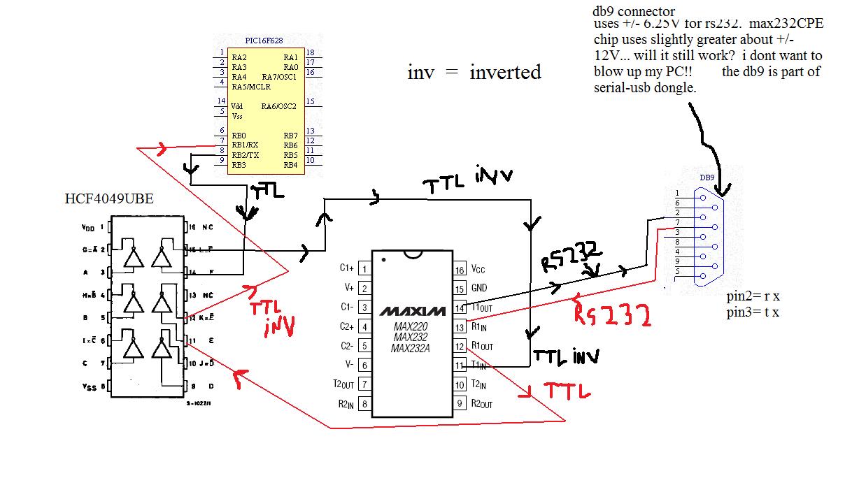

hi there... thanks for all your replies. i have purchased the chips from maplin(rip off), and drawn a schematic iv attatched it.
because people said i have to invert signal and level shift it, i thought i had to use a seperate inverter ic to invert, THEN feed the signal to the max232 chip. iv included the inverter ic in my schematic but you can ignore that as now i know i can just feed the lines from the pic directly into the max232 as this does the inverting?
a question tho, my usb-serial dongle uses +/-6.25V on the serial end for rs232..the MAX232CPE chip that im using uses slightly higher than this voltage...about +/- 10 or 12V. is it ok to still use this max chip with this dongle? i dont want to supply 12V if it takes 6.25V only and blow up my laptop or something. it may accept it but i just wanted the opinion of you guys, better to be safe than sorry. (capacitors and power lines etc have been omitted from my schematic)

here is my schematic

Your DB9 connections are wrong. You need pin3 (you have pin 7) to RX (via max232), pin 2 to TX and pin 5 to ground. I'm assuming a 1 to 1 cable to a PC.
The MAX232 does both the inversion and the voltage doubling.
You also need to add several more caps including the decoupling caps.

ok in some examples on the net, it shows capacitors with two straight parallel lines (circuit symbol), and some symbols with one straight line and one slightly curved line parrallel to each other, i take it the latter is polarised... this is the one iv seen in most examples so i take it i should use a polarised one which is called "electrolytic"? iv also noticed there are so many different shapes of capacitors does it matter which i use? i know i need a 1uF one, i just dont want to get the wrong one because there are so many types.
also please let me know if the max232 using slightly higher voltage than the +/- 6.25 V on my DB9 connection matters..will it still work without damaging my pc? thanks
