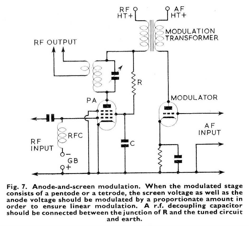

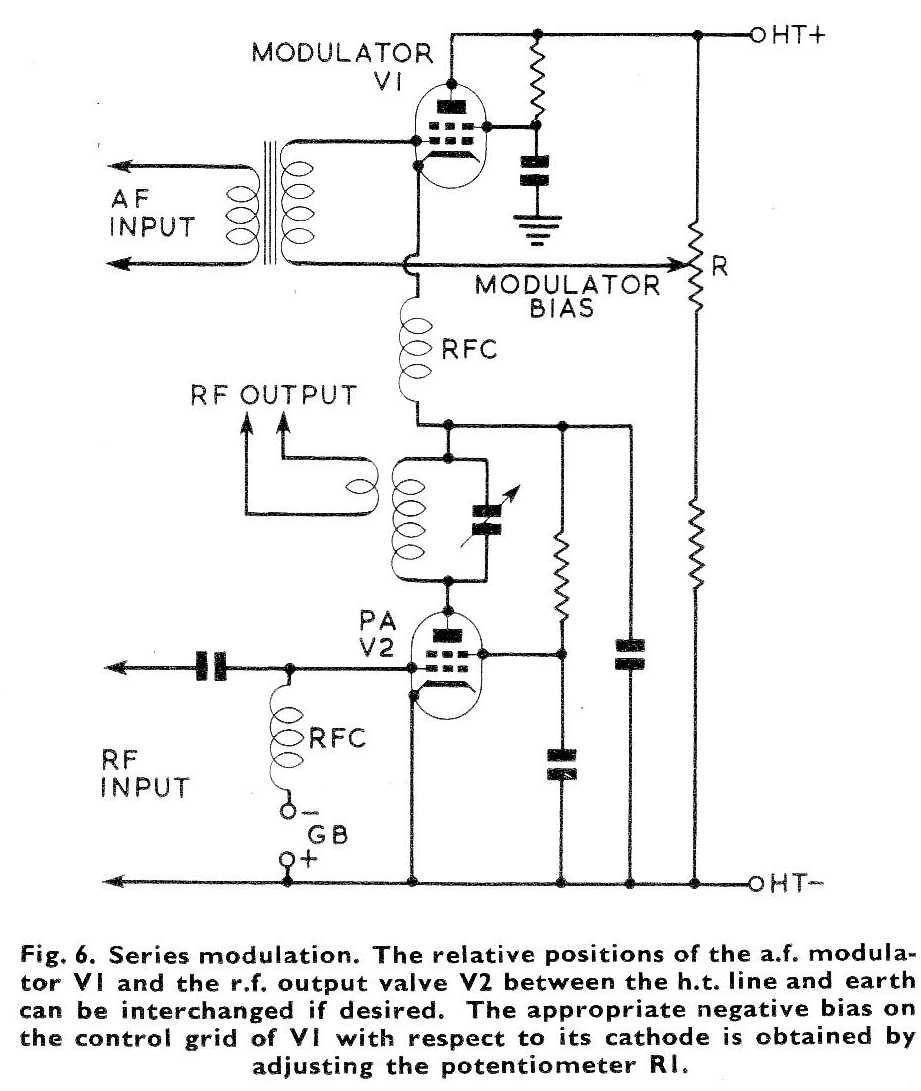

Try these two circuits, no integrated circuits there.

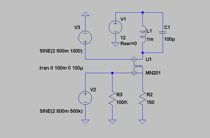

Hi Vikaschawlacv,
Here's one, . . . of many.
on1aag.

I like these answers. The scary thing is that I understand them. Yup, we must be "geezers".
I understand the MOSFET idea but not the valve idea as I'm too young to understand that. :D

I've no problem with valves, although the cathode follower circuit is a bit 'nasty' :D I far prefer the normal anode modulation using a transformer as your second example. You can also cathode modulate the PA valve, which is probably the simplest method? - but it suffers from similar limitations as the cathode follower example.
