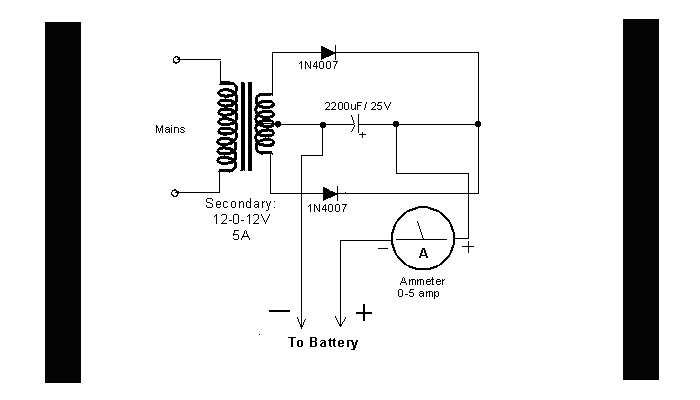

amp meter needed ?
gigster
does the amp meter need to be in this circuit ? for it to work? its a 12v battery charger

No it doesn't, although it's a VERY good idea to include it. You should also use a special transformer designed for battery charging, these are designed to current limit - a normal transformer may well destroy itself on a flat battery. There's also no need for the capacitor in a crude battery charger!.
so a 120v \ 12v 5amp transformer wont work? I made the charger and had a volt meter hooked up to the battery leads but when I plugged it in the diodes blew.I would buy a charger but where Im at (not in usa) they want 100+ dollars for a manual 6a charger.
Is there something I can add to protect the trans.?

One of the reasons the diodes failed is because they are only rated for 1 amp.
If you have a 12Vrms 5amp transformer, you should have at least 5amp diodes, I would goto 10amp, if possible.
Connect a 5amp slow blow fuse in the output from the charger to the battery. [say, in +V lead]
The charger should also be mains powered from a fused supply, 3A fuse should be OK.
I would also ground the -V supply from the charger to the mains ground, just in case the charger transformer develops a fault.
As chargers are sometimes used outdoors, it would be advisable to use a RCCB in the mains supply line.

And provide adequate cooling for the 10 Amp diodes.
At 6 Amps they will dissipate around 4.2 Watts each.
Also have the series resistor on standoffs because it will get hot.

5 Amps at 120 Volts is 0.5 Amps at the primary side of the TX.
A 12 Volts lead acid (car batt) requires between 13.7 and 14.4 Volts to fully charge.
At your TX secondary you should aim for an output voltage within that range.
A good value to start with is 10:eek:hm: which will give you a 5 volt drop at the primary and about 0.5 V at the secondary.
Rating should be 2.5 Watts. Get a 7 Watt ceramic wirewound resistor or put smaller ones in parralell. 3 of 30 :eek:hm: 2 Watts each (makes 10:eek:hm: )
You can do a bit of trial and error here. Be carefull with mains wiring and put on well insulated standoffs.
A batt charger is self regulating anyway. Initial high charging current when batt is flat, voltage of batt increases, hence less charging current, till a status is reached that charger volts equals charged batt volts.

I would fit a resistor in the secondary side, NOT the mains side - either in one of the leads from the transformer to the bridge, or in the positive lead to the battery.
Before I actually got round to buying a battery charger (which cost very little anyway), I used to 'throw something together' whenever I needed to charge a battery. A simple and easy current limiter is a bulb, try a headlight or foglight bulb in the positive lead and see what current you get - if the battery is dead flat the bulb will even light to tell you!. I used to use an old front foglight, which was a damaged one I saved - this always worked fine.

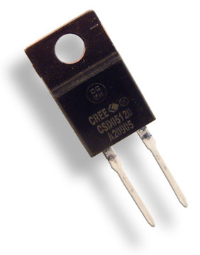

sounds like you got 10A bridge rectifiers. If there are 4 pins, 2 should be labelled with + and - and 2 should be labelled with ~
The ac voltage goes to the two pins labelled ~ and the two pins with + - will provide rectified DC voltage
