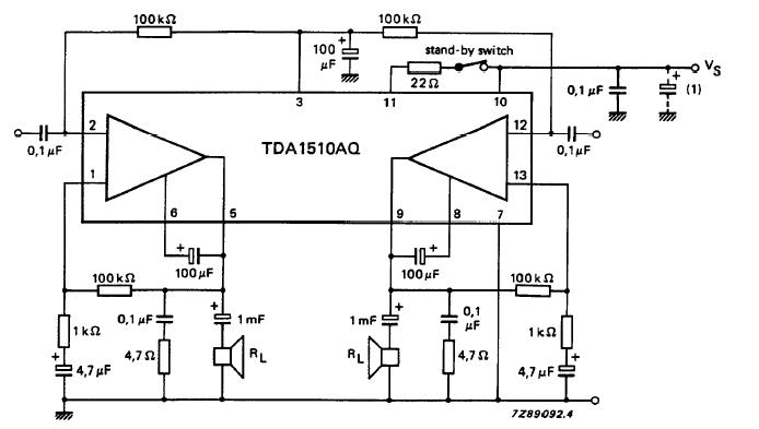

i want to build this circuit to power some speakers for my pc but there is a few points i would like help with
where would i put a volume control in this circuit
i need a psu for it ,i have a transformer with an output of 17v that i can

A stereo volume control can be connected to the inputs of that amp.
Its absolute max supply voltage is 18V, so a 17VDC supply would probably be too high when the amp is not playing loudly. It is made for cars with a 14.4V supply, and it can provide 4W to 5W to each 4 ohm speaker. With 8 ohm speakers its outputs are only 2.5W to 3W each.
Don't you have its datasheet? It was the 3rd link in a Google search for TDA1510.
https://www.electro-tech-online.com/custompdfs/2005/10/tda1510.pdf
Oh yeah, if your transformer is 17VAC, then it will give a rectified and filtered DC output of 22V when fully loaded and higher when it has a little load. Way too high for your amp.

Whats the value of the caps shown in series with the speakers ?
John :)
It is apparent from the schematic that all the micro-fahrad values
are written uF,
except that one.
Which is written mF, and i think that one micro fahrad is a bit
small to put in series with a speaker.
I dunno.
Why should that one be different ?
Is it one micro-fahrad ?
John :)
Hi John,
It is for a car amp with only 4W to 5W output per channel into 4 ohms, probably for those little 3.5" speakers at the front. The 1000uF (1mF) output cap reduces the power at 40Hz to half, but the little speakers can't go lower than about 120Hz anyway.
My computer speakers are 3". Their 4 ohms are driven by a bridged amp for each one which drives them to 12W each from a big, heavy 12VDC wall-wart AC adapter. Since their amps are bridged, they don't have output coupling caps reducing the bass and they rock!
My computer speakers actually move toward me for each beat of the music. The puffing from their vent at their rear propels them. :lol:
are written uF,
except that one.
I dunno.
As aibelectronics said, it's clearly labelled 'm', which means 'milli' and is a perfectly valid prefix for a capacitor, although it is true that it's very rare to see it used. So 1mF (m=10^-3) is 1000uF (u=10^-6), it could also be labelled 0.001F as well, all three are the same thing.

Thanks for pointing out that an mF is actually a thousand uF,
which puts that capacitor back into my concept of acceptable for the
job it is doing.
So its actually not one micro-fahrad, its 1000 uF.

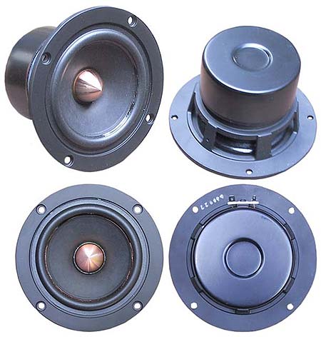

My pc speakers came with my new pc. I couldn't believe their heavy weight for their small size so (of course) I peeked inside. The little 3" speakers have a nice rubber surround and a huge magnet. I don't recognise the logo on the power amp ICs, they are Chinese.
They look something like these:
They look very nice, they look quite beefy for their size.
