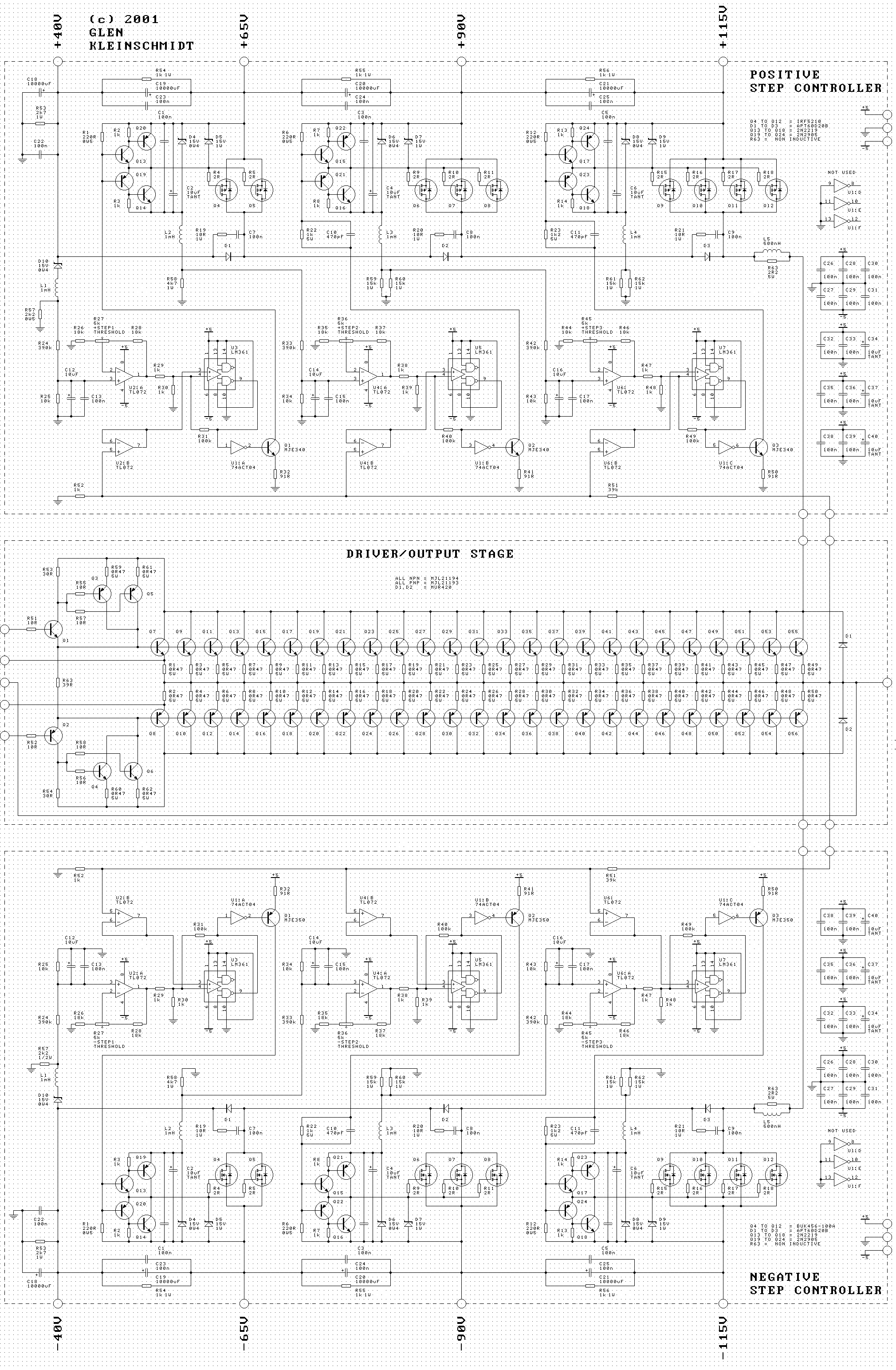

Here is an AMP Rated at 20,000 Watts
Wow, that looks like it needs its own power station!
Considering you can only draw 3KW from a single UK 13A socket, and considerably less from an American 120V outlet, it would certainly need it's own electricity supply.
In the 20kW amp, it looks like class-G is used to switch the power supply voltages for the 50 output transistors. Then at low levels the supply voltages are low for less heating.
