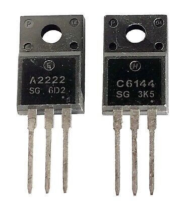

Hi can anyone give the pinouts and equivalents for the pair of Motorola audio output transistors MU9611 and MU9661 please. Cannot find any info or source at all, thanks, Barney.
It appears a 2SC6144 + 2SA2222 would be suitable electrical replacements, they have compatible characteristics, though the package & pinouts are likely different.
They are obsolete, but appear to still be readily available.

Thanks for that prompt reply, still have the undamaged pair so can work out the connections and will order two new pairs. Will be much appreciated by friends wife who can have her favourite retro record player back! Best regards, Barney.
