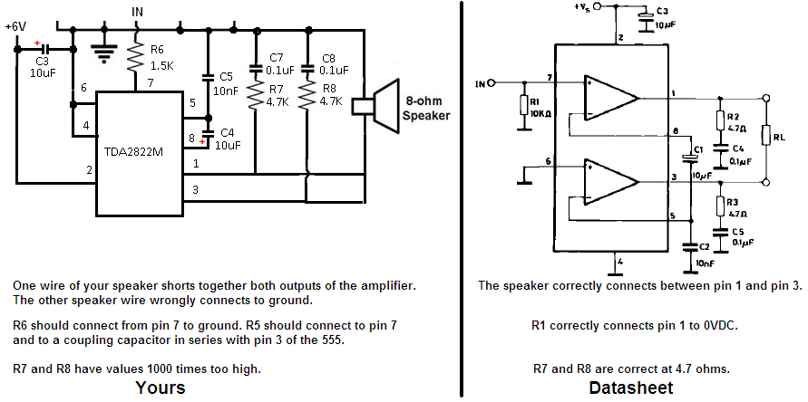

The datasheet for the TDA2822M shows a low power stereo amplifier with 2 speakers and huge output capacitors in figure 1 and figure 16, and also shows the bridged higher power amplifier with 1 speaker and no output capacitor in figure 2.
To reduce the 4.5V p-p from the output of the 555 to 80mV at the input of the amplifier you use a 100k resistor in series with 1.5k. The input of the amplifier is connected across the 1.5k resistor.

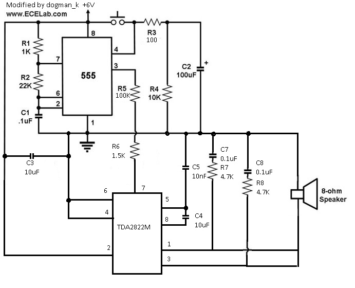

And this is my try at a modified version of the circuit based on Fig. 2. I don't have capacitor polarities marked because I could not figure them out.

The 1W from the amplifier will not be much louder than a cheap clock radio.
You made a few mistakes on your schematic:

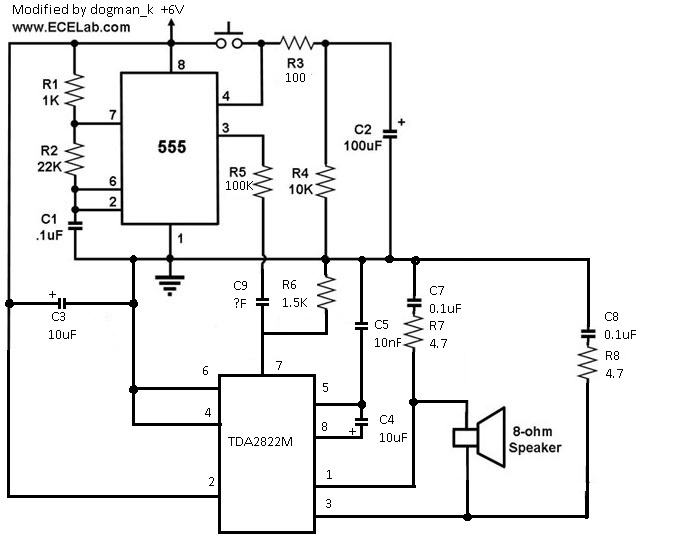

And here is my revised schematic:
Your revised schematic is correct.
The frequency of the oscillator will be 320Hz so the coupling capacitor should be about 33nF.
