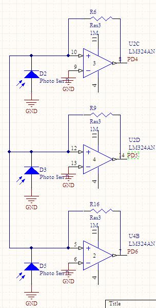

u mean something like this?
I thought you had a common cathode device.
How much speed do you need (risetime, bandwidth, or whatever)? Can you tolerate offset due to dark current?
yeah i do have common cathode, so u mean just switch the diode around in that diagram?
dark current is insignificant, other things like risetime etc are also insignificant from my knowledge.

The 3 amplifier circuit does not look like it will work. All three diodes are in parallel. What effects one branch will effect all branches. If this is what you want, just use one op-amp. It will do the same thing.:)
Why not use 3 seperate photo diodes with seperate op-amps?
