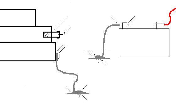

Now i am not clear where you are putting the probes
of your meter when you say:
"the potential from the head to the batt(-)"
You are dealing with very small voltages and you have
to measure in the right places.
I have attached a small pic, you may be aware that
these places are potential problems, but you may not
be aware that wherever dis-similar metals are touching
there will be a potential difference.
This normally does not matter, as such voltages are
quite small.
However where thermocouples are involved these voltages
can be significant.
They are not just caused by poor connections, that may
require cleaning, these voltages are because of dis-
similar metals coming into contact.

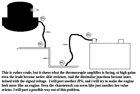

Also, you mention there are spurious voltages getting
into the signal area with the engine running. These i
guess are from currents flowing along 'shared earths'
You say you have tried with the amplifier earthed at
the thermocouple, but of course the battery ground
would go through several other junctions to reach the
case of the thermocouple.
I think your best answer would be to modify the thermo-
couple into a two wire unit with no ground.
I think your problems now are with earth/ground currents
interfering with the signal, such currents when the unit
is running could be from charging, or just the ignition,
or maybe injectors, most units share the common ground
connection, and i don't see how you could easily isolate
the thermocouple signal from other currents sharing the
Batt(-) terminal.
It might be possible to run a (slightly) lower voltage
supply from the 12v rail, with its own earth at the
thermocouple casing, if you were willing to make an
additional connection at the thermocouple.
I will follow up with a possible diagram.

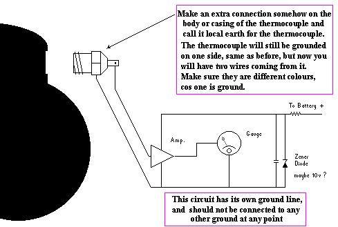

This circuit put forward,
does not quite have an independent supply,
but almost.
For it to work as intended, if there are any other points
within it that require grounding,
they should be taken to the 'local ground for thermo-
couple' so that the circuit can not be affected by
any ground currents, or odd Pd's.
I hope the circuit is clear to you, it is partly
pictorial.
If you think this may suit your needs,
then i or someone else will try to approximate the
component values for you, based on what you need.
Best of luck with it,
John :)

Hi Ryan,
Well,
it might be easier to fit the independent supply you speak of
than to try to make it work on the existing one.
you say you tried wiring the ground for the amp to the same
location as the TC.
Well, the ground for the amp, and the ground for the gauge should
be connected together, and taken to the body or casing of the TC
and not connected to any other ground except at the thermocouple.
If there are lamp(s) fitted into the gauge, to light it at night,
check that the ground wiring for the lamp(s) is not connected to
the circuit for the gauge.
