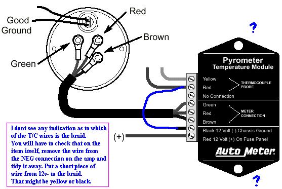

Hi Ryan,
I've had a bit of a think,
and i would like you to try something.
I would like you to move the ground wire on that amplifier unit over
to the Thermocouple ground connection.
I am not sure about the fixings on the amplifier, but my guess is that
they are not internally connected to anything.
However, just to be sure, would you mind just temporarily removing
them and maybe putting a bit of cardboard under the amplifier,
maybe a bit of tape or something similar, it can be screwed back down
afterwards, i just want to be sure that there is only one ground track,
for this check.
The gauge, ... i agree, it doesn't look like it has an earth/ground
connection at all. Thats ok, it doesn't need to have.
The lamp in the gauge does look like it is not connected in any way to
the circuitry involved with it.
The unit is supposed to run through a 1 Ampere fuse, so it takes less
than an amp, i don't see a problem running it through the braid, thats
the shielding around the thermocouple signal wire.
But it might be interesting to see just how much current it takes.
But don't worry about the current for this check.
I've included a pic, partly copied from the links you gave me.
Doing this should give a similar situation as you had when you gave
it a separate supply.
Lets see if this gives some sensible results, i have my fingers
crossed !
Cheers, John :)

Been there already. That was one of my first attempted fixes, no go.
The ground to the light definately does not connect to the gauge in any way. The amp enclosure is all plastic and the terminal block has insulating foam on the bottom to prevent shorts. The only ground source/s coming in are from the TC and the ground lead.
Already did a current check last night. This threw me a curve and I'm still questioning that I did it right. On the 2mA scale on my MM, I get a reading between .001mA and .002mA. It's a digital meter so it just kept going between the two values. Is it just me or does that seem low? I know it's accurate, but geeze. I know it's not a conventional gauge so I wonder if it only really draws current when the needle is in motion? If that's the case then I'm not even sure how to get a good reading w/o data aquistion of some sort. I can torch the TC for quick movement, but watching a digital MM for changing values isn't really accurate.
I'm guessing however that 2W DC/DC converter would be plenty for it, it was rated at up to 167mA so I would presume that should do the trick,,,, unless of course another solution is somehow found - fingers crossed. Real puzzles are always the best ones. And in the meantime I'm still just carrying my MM with me and using it to take readings from the TC. Not as elegant, but effective nonetheless. --Ryan
Quick little PS here. Found the converter at Digikey. There are two with identical specs, only difference is package type. What's the difference between 28-SOIC and 14-DIP? What's easier to work with? Thanks, --Ryan

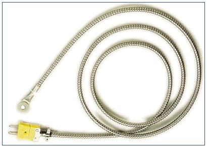

Yes, "the metal conduit that the wires run through"
sounds to me like it, we call that braid or braiding
if its very flexible covering of interwoven thin wires.
Or i suppose it could be a sort of flexible metal ribbed
tubing with the T/C wires inside it.
Please describe it.
This pic is not very good, here it looks like ribbed
tubing.
As for connecting additional resistors on the T/C, no
that makes no sense to me. The output is feeble, 100 or
200 ohms would only reduce it, as you say.
You are correct about the thermocouple wires, but the
amp i think is balanced.
So if you have a leak from one side of the T/C to ground
you can earth that side, and ground that side at the amp.
That may not have come out very well explained.
Please describe the T/C wire.
John :)

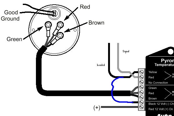

Hi Ryan,
I'm now starting to think that maybe that thermocouple was
a balanced type, but has maybe developed a fault to ground.
If the amp has a balanced type input, then the faulty side
of the thermocouple can be connected to the 'sheathing' of
the thermocouple and also to the amp ground, this should
be acceptable to the amp, and remove earth current
interference.
Excellent description BTW.
How did you get on with the continuity tests ?
(three checks)
So,
revised picture on its way, sorry I'm a bit slow .... John :)

Hi Ryan,
If you think that the tiny voltage from the thermocouple
is influencing the reading, then just try it both ways round.
The T/C output might be discern-able as a small difference,
but you should be able to judge the mid position.
You sound pretty knowledgeable to me.
Anyway, its the 'sheath-to-T/C' that i am interested in
mainly,
as it is my feeling that you have a fault to ground on one
side.
This fits with the scenario of working OK with an isolated
supply,
but not with its on-board supply in various modes.
So,
If this is the case, then there are two possible faults to
ground.
One wire, or the other wire.
Since i cannot tell them apart, other than by their output,
i suggest trying both situations.
I have drawn an arrow on the 'sheath-and-ground' wire(s)
please try this in the thermocouple terminals, one at a time.
One of them should give the hoped for results.
If this isn't clear, just say ...ok ?
try it on the top terminal, (yellow)
if no good, try it on the second terminal. (red)
What this will do is ground the side of the T/C, if thats the
fault to ground thats ok, if not try the other.
If you're tired then thats ok till tomorrow.
I hope this sorts it out.
I have my fingers crossed.
John :)
Hi Ryan,
Something else has just occurred to me,
you will probably have to slip some insulation
over the T/C sheathing,
to prevent it from grounding anywhere along its length.
Unless you can just grommet where it passes through,
see what you think anyway.
John :)

Hi Ryan,
Oh yes, you're right, reversing the thermocouple connections
would reverse the output to the gauge.
I'm a bit curious about what you mean by 'bridging the
ground to either lead'
for this, it doesn't want any other
ground applied. Doing so would provide another ground loop
and possibly give false readings.
I've drawn the sheathing and the amp (black) terminal joined
and to be treated as one wire, try it on the yellow and the
black, without crossing over the thermocouple wires. By
Using the sheath as ground at the thermocouple end, the fault
becomes irrelevant, so long as it is the only ground applied
to this unit and amp.
You would have to check (visually) that the sheathing doesn't
touch ground anywhere along its length, insulate if necessary,
maybe grommets would do, see what you think.

If this cannot cure your mis-reading problems, then yes, you
will probably have to fit one of those little isolated supplies
that you spoke about before. I'm not very familiar with them.
Best of luck with it, John :)
