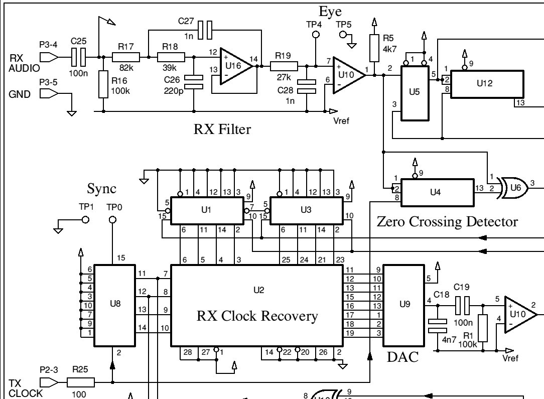

I want to make an FM radio and then convert it into a wireless serial port network card. Then I will use it to access the internet. Ever heard of "Packet radio modem"? I want to make it.
The maximum frequency I need is 460Mhz. The frequency I need to connect for 9600bps is between 450Mhz and 460Mhz. The frequency I need for 1200bps is between 145 and 146Mhz.
I am trying to pick up 102.9Mhz without success. Doesn't current and frequency and volume (amplification) go hand in hand?
I clicked on the GIF links for the circuit and I didn't see any circuits. Can you post them or give me another site?
Perhaps you are clicking on the wrong links. Sentence 2 reads:
Fig 1. The modem schematic. Broken up into four parts for legibility: Figure 1a (42K), Figure 1b (31K), Figure 1c (36K), and Figure 1d (31K).
In this sentence, words like "Figure 1a" are blue in color and are underlined. When you click on the word "Figure 1a" (for instance) you will be directed to a portion of the total schematic diagram for the 9600 baud packet modem. This is the circuit.
I clicked on those and I get blank pictures. maybe their site isnt working.
I wonder if I am the only person who can see these?
