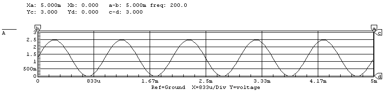

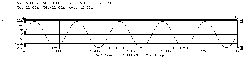

I am trying trying to make such a circuit which amplify AC signal comming from sensor(Sensor may be any one, no talk on sensor). Sensors output is varing from 0~20mVolts feeding this output to OPAMP (TL072) amplify this output, now ouput is 0~1.25 Volts coming from opAMP output, Now the problem is how to super impose this wave to a DC level of 1.25 Volts using OPAMP.
I mean i want to amplify the AC signal and want to change the DC level to 1.25 Volts using opAMP.
In simple First picture is Input & Second picture is output.
How we do this using opAMP, guide me.
Thanks.

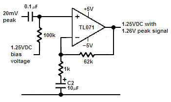

You can easily bias an opamp to give a 1.25V DC output, and AC couple the input, this will do what you want. The only question really is why do you want to do it?.

Here is a circuit with some magic resistors to do what you want:

Thanks all who reply.....
Audioguru ur circuit is working and giving required output, but the problem is, it is AC coupled with sensor, Is there any other technique, a circuit that give same result but not AC couple.

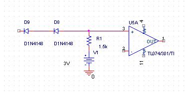

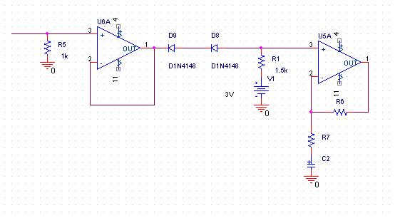

hmm well if ur sensor's output impedance is low enough u could use 2 diodes instead of a capacitor like in the first circuit... u must tweak the bias resistor to get the desired bias level. Or u can use 2 opamp like in the second pic...
Mb others can verify this...
P.s. R5 from second pic should be higher (depending on ur req) i forgot to delete the value :p
