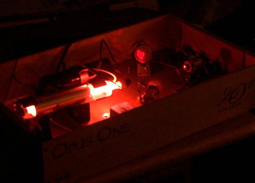

This does not answer any of your questions, but since your into lasers, I thoght I would share a little project I built with a laser. Simply a laser tube, power supply and 3 motors with mirrors mounted. Regular mirrors do not work. You need the kind used in laser stuff (I can't remember the name).

First (or front) surface.
That sounds about right. They were also made from silver I think. The rear coated mirrors simply do not work. Too much diffraction in the glass. Laser light ends up looking like fuzz.
Kinda expensive too.
