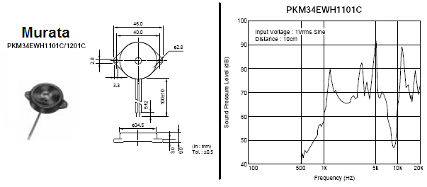

Here is the frequency response of a Murata piezo transducer. It is horrible.

A siren in North America sweeps its frequency up and down. A piezo transducer doesn't have any output at low frequencies and one high resonant frequency is very loud.
It won't sound like a siren. It will sound like a beeper.
