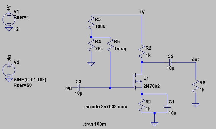

tnx audioguru i forgot he had MOSFETs available. i just put something together with a 2N7000, single stage common source with a gain of 30, input impedance 1Meg, output impedance 1k. the trick is that with a MOSFET, the bias network can be isolated with a 1Meg resistor. i'll let the OP take it from there.....

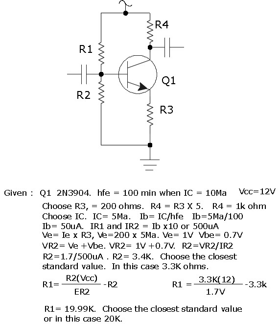

I agree with other posters, you need to use the fet as an input as an souce follower for the high imput impedance. As I recall if you design a common emitter amplifer and center bias it, that is to say the collecter at 0 input signal is near 1/2 Vcc you will get a good unclipped sinewave on the output.
The attacted diagram is a typical design for center biasing a common emitter amplifer. In this design the gain is pretty darn close to Rc/Re. Yea is is for a 2n3904 but it can be redone for a different transistor. Also if I remember correctly the Ib biasing resistors affect the input impedance and are essentially in parallel for the AC signal. A further need for the FET as the input amplifier.

ok, i didn't want to do the OP's work for him, but here's what i came up with. the 2N7002 and the 2N7000 are almost identical with the only real differences being the max Id and Vds. notice the bias network isolated by a 1Meg resistor. this is one of the advantages of using MOSFETs, the bias only needs to be a voltage. play with the bias point and the drain resistor. the source bypass cap gives the stage higher AC gain while allowing the source resistor to provide a stable DC operating point. adjust the source resistor as needed.
