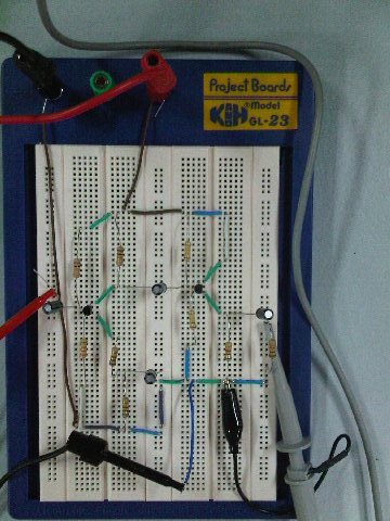

I spaced them out so it can be simpler for me to visualize things.
Then the circuit might oscillate at a very high frequency due to the high stray capacitance.
Many high frequency circuits do not work if they are built on a breadboard.
Many years ago I made a circuit on a breadboard. It didn't work. Then I made it on a compact stripboard and it worked perfectly. I never used a lousy old breadboard again.

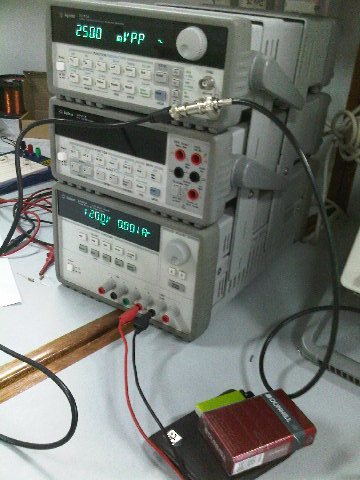

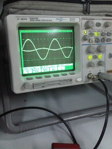

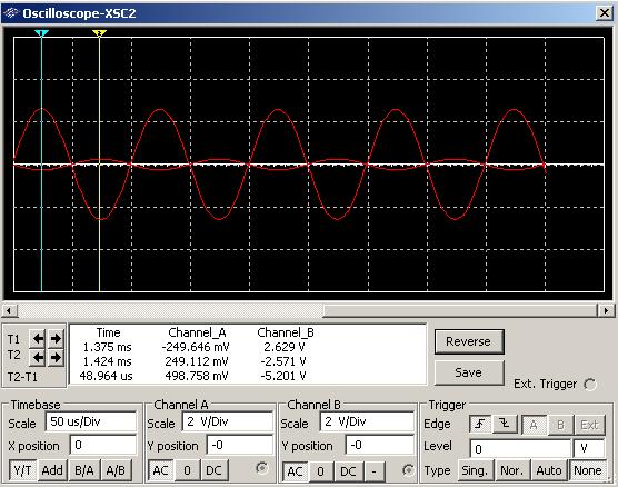

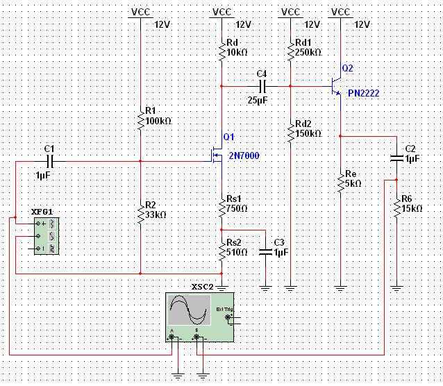

Update 2 :)
I tried satisfying the requirements without using the feedback resistor, since that stuff is so hard for me to understand in AC Analysis >.< (something along the lines of miller effect and a weird looking feedback pi-model which completely intimidates me), and I succeeded on MultiSim.
However, when I implemented the circuit. My gain was ~ 9 no matter how much I played around with Rd, Rs1 and Rs2 whilst trying to keep the ratio of (Rd/Rs1 +Rs2) ~ 10 and a proper unsaturated output waveform.
Any ideas?

Like all mosfets the 2N7000 has a wide range of transconductance from 100 to 320 typically to (they don't say how high) at high current. They don't say how low is the transconductance at the low current you are using.
You need additional amplification from the transistor.

try reducing your total Rs. it's the ratio of Rd/Rs that is the primary determining factor of the gain, and the emitter follower has a gain of LESS THAN 1.
To increase your AC gain you need to decrease Rs1. You can maintain DC stability by keeping total Rs (Rs1 + Rs2) the same.
Try Rs1 = 200, and Rs2 = 300.
