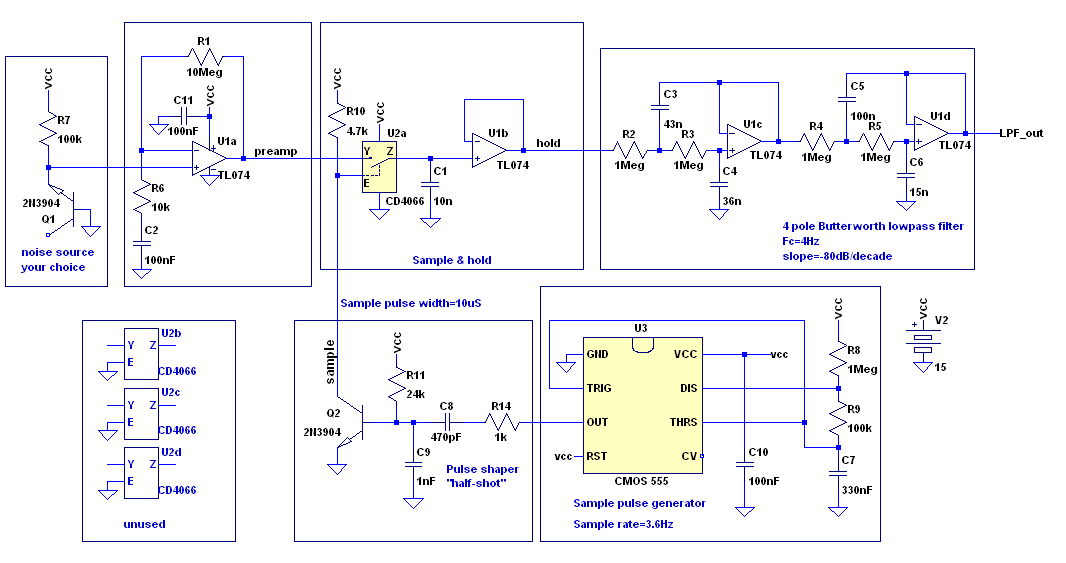

I was working on a circuit for you, but I got distracted. What you posted could work, but the devil is in the details, as always. Hang loose.
OK, here's a circuit that should work.
I have no idea what the amplitude of your noise source is. You might need more or less gain. You can still add gain in your first stage, since bandwidth should not be an issue. You could also add it before the filter, but be aware that the signal there is centered around the Veb breakdown voltage of the noise transistor, so adding gain after down sampling recreates the low frequency cutoff issue. I avoided that in the first amplifier (note C2, the 100nF cap). I was able to do this because the down sampling takes the higher frequency noise which is passed by U1a and folds it down below the sample rate. After the Sample and hold, any gain added has to have a very low frequency cutoff, probably in the milliHertz range, depending on your requirements.
In any case, the filter output as designed also has a big DC component, so you will probably have to cap-couple the output to get rid of the DC. When you do, be aware of the low frequency cutoff which cap coupling causes.
It might be better to use dual supplies, and remove the DC component before the gain stage. Then all the low frequency cutoff issues are moot.
What is your application?
Do you have the capability of using dual supplies?
Without even really looking at this, I have to say that you are a gentleman and a scholar.
In other words, thanks. I'm going to go over this later. It looks like just what I'm needing.
I think I need to back off this project for a moment and get the right stuff. I've been using just what junk I had lying around, which is part of the problem.
The other part of the problem, to answer one of your questions, is that I was attempting to run the whole project from a single-ended supply, using a LM324. I think it's time to break down and get (meaning build) a proper dual supply, and not have to worry about DC offsets and other nonsense. Plus get some new parts. Time to put an order in to DigiKey, or perhaps Jameco ...
To answer another question, my purpose is not clear at this point. One really dumb use is to simulate a flickering light, such as would be produced by an arc welder. But I have other random-noise-related things in mind as well. We'll see ...

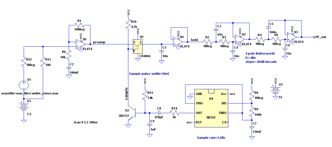

This "sample and hold" solution doesn't output only ones and zeros. The comparator has been removed (replaced with amplifier) and after that comes sample-and-hold + low-pass filter.

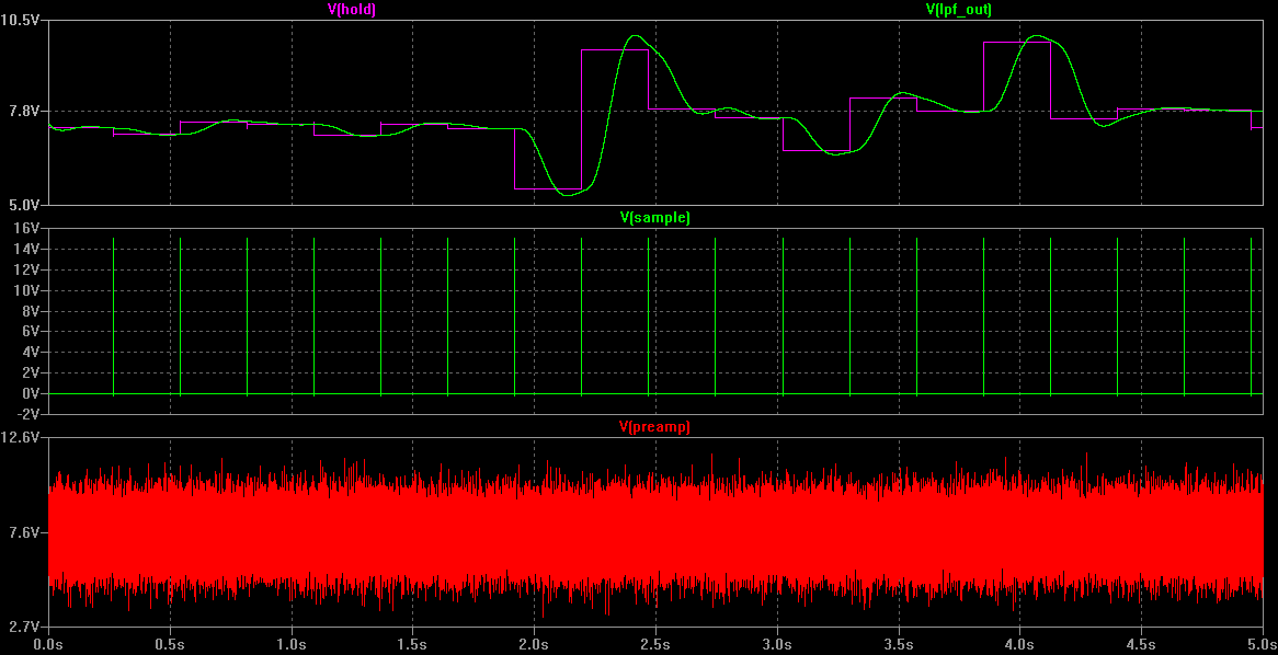

Here is the schematic that I actually simulated, the resulting waves, and a few other supporting files, in case anyone else want to run the sim.
