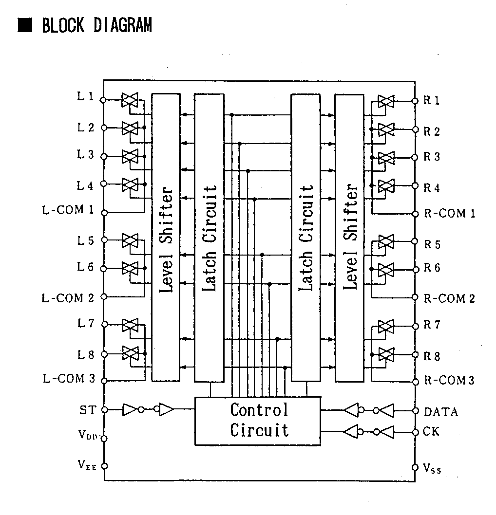

The NJU7313AL analog function switch on my receiver failed and cannot find a replacement in our area. Im thinking of replacing it with an equivalent circuit or worse, a manual selector switch. Could someone provide a circuit design. Attached is the block diagram of the NJU7313AL IC.
