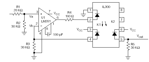

Also existiert the real analog opto with monitor diode...
Sebi, that is alot better cct then using a plane old opto-coupler setup
The worst thing abt using opto-couplers in their linear region to isolate an analogue signal is over time as they age their linearity severly deteriorates.
With the method there is a feedback of such a deterioration. However, the downside of this is, as the opto starts to deteriorate (and it will after not that long), this closed-loop will over-drive to compensate, and thus age it faster.
Admitidly it will last alot longer (as in with usable characteristics, plus general use) than no-feedback.
