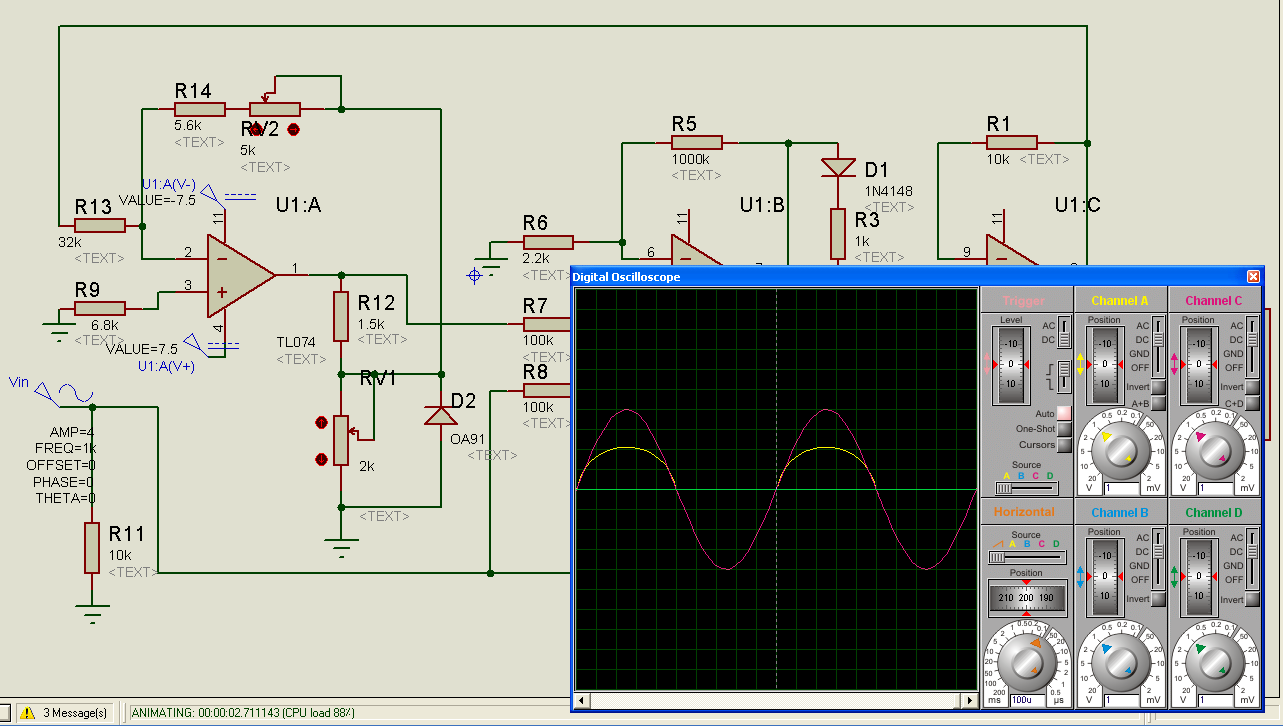

Hi guys,
I wanna make a square rooter circuit so that take the square root of a sine wave, The idea is to add some DC-OFFSET to the sine wave so that I have a Completely positive sine wave.
I decided to use op-amps for doing so. I want to take the log of the input signal then multiply the result by a factor of 1/2 and final take the anti log of it. The result would be the square rooting of the input.
Please take a look at the below square rooter circuit and give me your idea.
The main problem which I am dealing with is that I am not sure adding some DC offset to the input and finally removing it by a capacitor at the output will give me the proper signal?
Thanks a lot:eek:

This sounds highly bizarre? - if you want to DC shift a sinewave then there are many much simpler ways (and probably none more complicated and less effective).
Just use a single opamp to shift the sinewave to positive only.

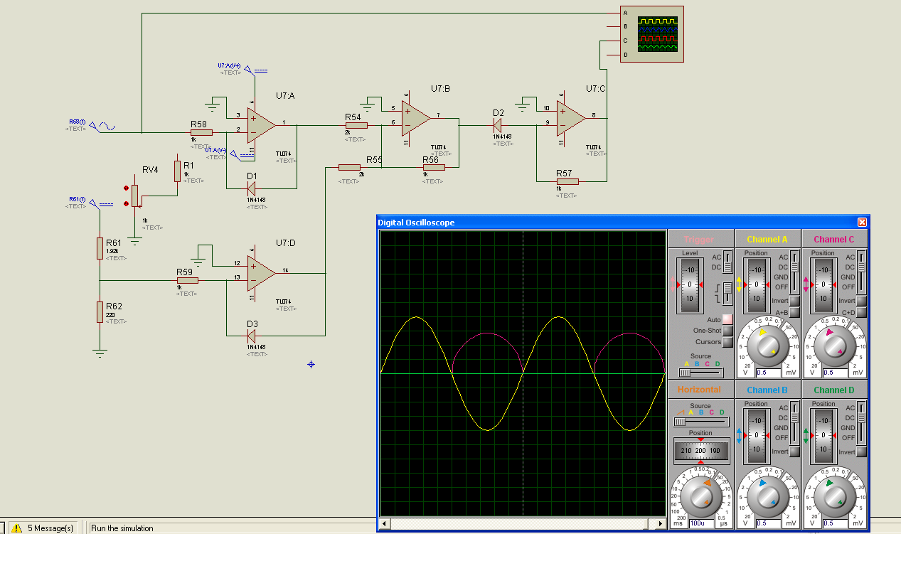

Ok here's the result in The Proteus Software, where the input signal is -2Vdc (you can see it in yellow), you can see the output which is 1.4Vdc in red. Good result, but I am not sure what is the best way to add the DC-Offset for A SINE INPUT? And I am not sure If the result would be ok by adding a dc-offset or not?
Suppose I add say 4V dc offset while the input signal is Vmsinwt, can you please let me know what would be the output result? I am not sure if I'll get √4 + √Vmsinwt or ill get
√(4+ Vmsinwt) at the output? I should try it by Proteus after I find the best way to add DC offset to the input.

Actually the Dc offset which I want to add is not what you have seen in the first pic as "Voffset". Actually the circuit itself needs a DC offset for the center op-amp which multiples the LOGed signal by a factor of 0.5 (I do not why it needs an offset but in the second pic in my second post you can see how I added the said offset for the center op-amp which is what I have seen in the original circuit).

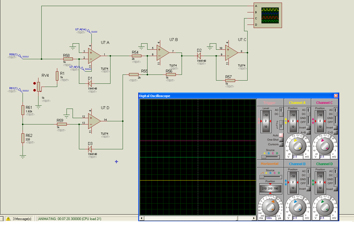

Any idea regarding my question please? How to add a dc offset to the AC signal so that the AC signal does not be affected by the DC offset? I do not want the domin of the Ac signal to be reduced due to DC offset volatge.
By the way no one knows if the circuit takes: √dc-offset + √Vac
or it takes: √(dc-offset + Vac)?
I noticed if the circuit takes the later then the output will not be a correct square rooted signal, Are you agreed with me regarding to that?

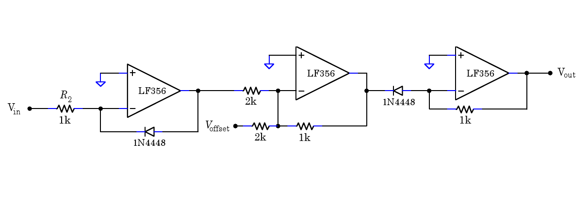

I would run the sin through the √ process, then pipe both the signal and the offset into the two ports of an adder. The output of the adder should be the √(signal) plus the pure offset. **broken link removed**
By the way no one knows if the circuit takes: √dc-offset + √Vac or it takes: √(dc-offset + Vac)?
Correct, you do not want the sum of the DC and the signal getting sqrt'ed. The signal only should be sqrt'ed. The method I suggested above should do that.
That;s right. But do you know that by doing so we'll get an output in form of
(dc-offset + Vac) at the output of the summing op-amps? Then transferring the said signal to the square rooter circuit will give us an output as :
√(dc-offset + Vac).
How do you think that your method is doing so? I don't think so.
Please any idea how so I take the square root of a sine wave yet letting the negative section to be squared rooted too? You guys know that it is not possible to take the square root of a negative wave form. The only solution which I reach to was to add some DC offset to the input so that the whole dine wave which I want take its square root becomes positive, But it seems that the output would be √(dc-offset + Vac), And I do not know how to trim it so that I get the correct square rooted signal.

Hello again drpower,
Yes i think that makes sense, and explains what you are trying to do a little bit better.
It seems that you want to take the square root of sin(wt) and you found that since that wave goes both plus and minus that you run into trouble when it goes negative because a simple square rooter circuit can not deal with the negative input. So first try is to add a DC offset to the original signal sin(wt) but then you end up with sqrt(sin(wt)+k) instead of sqrt(sin(wt))+sqrt(k), so you need another approach.
The next idea is to take the absolute value of the sin(wt) and then take the square root of it. That way you have a completely positive output and it really is the square root of |sin(wt)|. So first you run sin(wt) through an absolute value circuit, then run it to the square root circuit.
If you need the output to go negative when sin(wt) goes negative then we'd need a little bit more to detect when the input goes negative, or build the circuit a little differently to handle the two cases plus and minus independently and then add them back together. I think you want all positive though if i understand you correctly.
So you know what an absolute value circuit looks like?

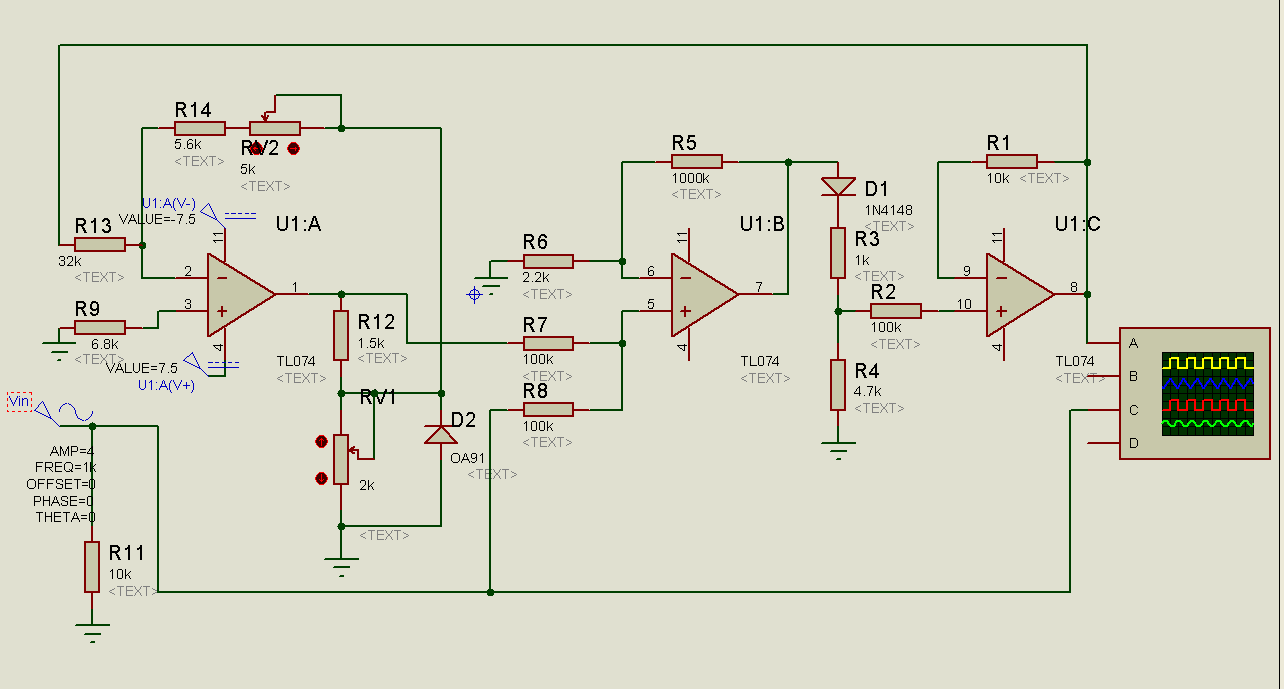

Ok For now I give up for an approach to solve the problem I dealt with And focus on the square rooter circuit itself. I simulated a square rooter circuit which seems to be much better than my original one in previous posts of this thread. the below pic is the one which I talk about. It works just fine as a square rooter in simulator but I do not know why it does not work when I made it practically?
Any idea plz?
Here's the link for the said circuit which I simulated...:

That circuit looks a little strange. Did you check it for numerical accuracy?
Basic tests:
When you input 0.25v, did you get 0.5v out?
When you input 1v, did you get 1v out?
When you input 4v, did you get 2v out?
When you input 9v, did you get 3v out?
I ask because certain parts of the circuit look very unorthodox (R2 for example).
They make pretty good multiplier chips these days i think so you may be better off with a design based on a multiplier chip.
You can also consider using a micro controller chip with built in AD converter and DA output.

Thank you very much MrAl,
To the second circuit I agreed that It is a bit strange (the Link of my above Post explains how it works But I am not able to understand it..).
I tried the circuit for voltages of one and bigger than 1 in the simulator, and it actually works. The link says that the first stage is a squarer but i don't know how they take the square root by a squarer circuit!
As I told I made the above circuit practically but It did not work in practice!!
Now I want to back to the first circuit and make it practically to see the results.
One question which I have is that I do not now what is the functioning of "U7: D" here in the circuit (Plz take a look at the below pic)?
The disner says that it acts to give an offset to the circuit and to normalize the signal. I can not understand why they need it and why they used such a circuitry to generate an offset? Why they put a diode in the feedback loop of U7: D to generate a DC offset? Why they do not use a normal voltage divider?! (the explanations regarding the circuit are here:
https://docs.google.com/viewer?a=v&...qHUkjw&sig=AHIEtbR-h2_IX6byp-m6pXdFE1zgXr91zQ ( pLz take a look at "D.2.2" and "D.4")).
I want to remove he D7: D somehow and use its op-amp in the output so that give the input a 180 degrees phase shift so that I could give positive signals to the input (if you tak a look at the below pic you'll notice that it accepts the just negative inputs not positive ones).
MrAl can you give me a view of D7:d stage please?
thanks

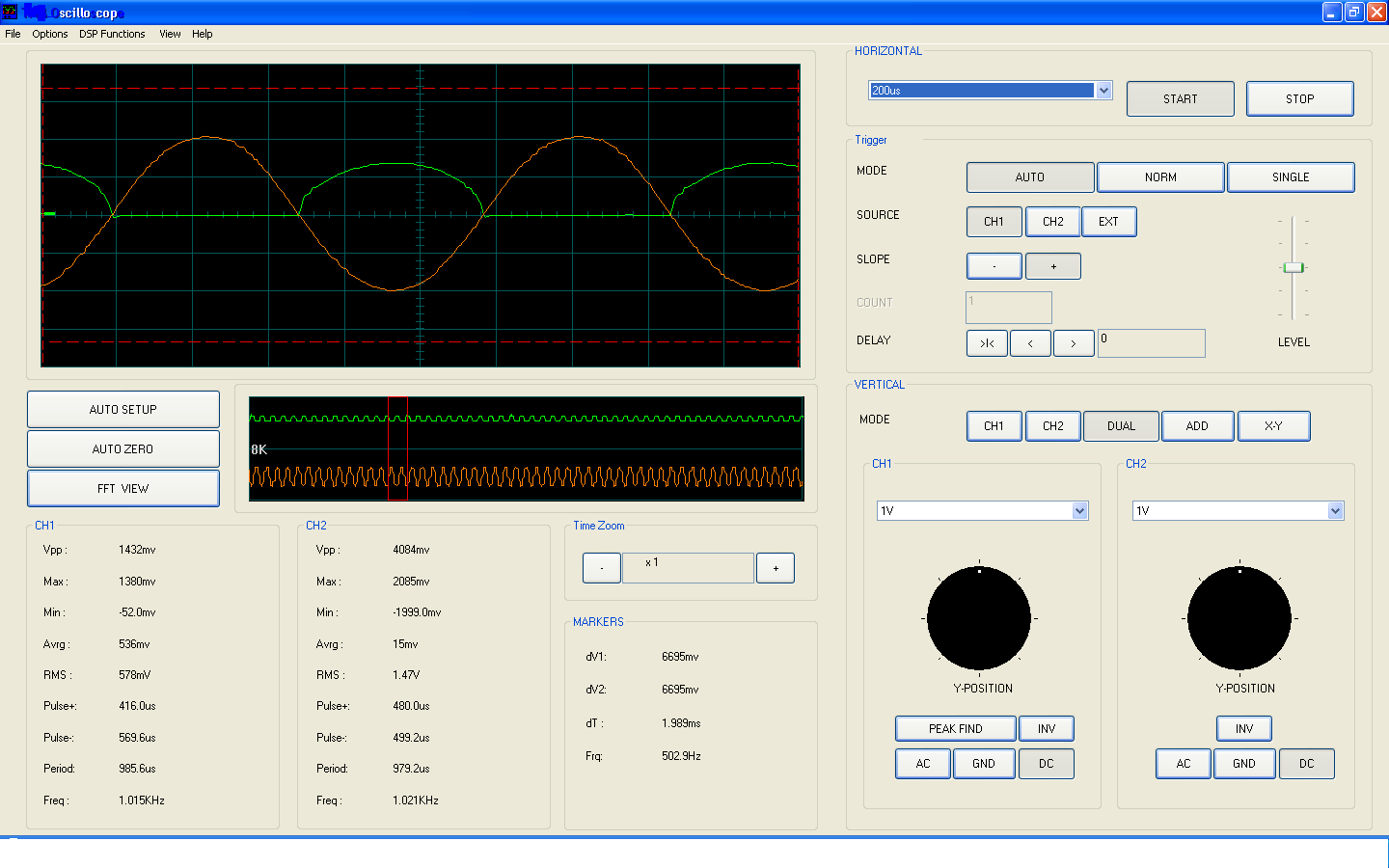

Ok here's the results of this circuit in practice while the input peak is almost 2V:
So the original circuit using 4 op-amps as "log -> x0.5 -> antilog" works in practice.
I have to perform some trims on it to get the best results.
Any idea plz?
