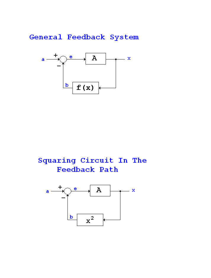

Hi again drpower,
One thing i almost forgot to mention is that with that lower U7 op amp section, if that is changed to a constant voltage you may loose some temperature compensation. That means the circuit may drift more with temperature. That's if they used that section to help temperature compensate that is.
Now on to the feedback system with the squaring circuit in the feedback...
See the attached diagram. First we'll look at this intuitively, then mathematically. Im saving the log anti log circuit theory for next time because this got quite large.
The upper circuit is a general feedback system. The input is applied at 'a' and the output
appears at 'x'. 'A' is the feedforward gain, 'f(x)' is the feedback function. f(x) takes
'x' as input and the output of f(x) appears at 'b'. The round circle is a subtractor,
which computes the difference a-b and the difference appears at 'e' so:
e=a-b
This gets amplified by the amplification factor 'A' and we get 'x':
x=A*e
Since x feeds f(x):
b=f(x)
That's the general system. When f(x) is a squaring circuit, then f(x) becomes:
f(x)=x^2
and we get the system shown on the bottom.
To view how this works intuitively, we start with all variables equal to zero.
This means a=0, b=0, e=0 and x=0. We'll start with a gain for A of 1000.
Now we apply an input at 'a' as some positive voltage, say 4 volts. This means
e jumps up to 4v because b is still zero. That 4v gets amplified to 4000v
(remember this is theory, in practice this would saturate) but x doesnt appear
as 4000v right away because there is also a small delay in A, so say we see
initially 1v at x (it ramps up as time goes on depending on the speed of the
op amp). That 1v now appears at the input of x^2 and so b becomes 1^2=1v.
Now we still have a equal to 4v but now b is equal to 1v, so e changes to
4-1=3v. Note that e lowered a little already. By this time, x becomes larger.
Say it went up to 1.1v in that time. Now the input of x^2 is 1.1v and so
b becomes 1.1^2=1.21v. Note now b is even larger than before.
Now the output at e is 4-1.21=2.79v and so it went down a little more.
x is still ramping up, so say now it became 1.2v. That means b becomes 1.44v,
and this process continues until the circuit reaches equilibrium, which is
when e*A=1.9995000625 approximately. That's not exactly the square root of 4,
but it is close. The reason it is not exact is because A is not infinite in
a real life op amp.
If we let A get larger, say 10000, we get a better result at the output:
1.999950000625v which is closer, and if we make A ten times larger (100000)
we get 1.99999500000625 which is even closer yet.
So we see that the larger we make the op amp gain A, the better result we get.
That's the basic way negative feedback systems work.
Now we'll calculate this system output using some math...
Following the signal flow shown by the arrows from left to right, we have:
e=a-b
x=A*e=A*(a-b)
and for the lower feedback section we have:
b=x^2
so inserting this last equation into the previous one for x we get:
x=A*(a-x^2)
We now expand this and get:
x=A*a-A*x^2
and collect terms on the left we get:
x-A*a+A*x^2=0
and this is just a quadratic in x so we solve that and get two possible solutions:
x1=-(sqrt(4*a*A^2+1)+1)/(2*A)
x2=(sqrt(4*a*A^2+1)-1)/(2*A)]
In terms of the op amp, A is the open loop gain typically very large, so the first
solution will be negative so the second solution is the correct solution here:
x=(sqrt(4*a*A^2+1)-1)/(2*A)
Since A is very large typically 100000 for most op amps, in theory we make this infinite,
so we take the limit of this last equation as A approaches +infinity and we get:
x=sqrt(a)
which is simply the square root of the input. Thus, we've managed to use a squaring
circuit to obtain the square root.
Next we can look at the diode equations and the theory behind the log antilog circuits.

Thanks you very very much MrAl for your long and complete writing:eek::eek:.
It makes sense somehow now.
Regarding to the feedback pic I can remember that we had a formula for it as:
T(s)= A(s)/(1+A(s)xf(x))
Where as you mentioned If the f(x) happens to be quadratic then we'll reach to the sqrt function of the function.
Ok today I just found a chip which takes the square root of the input too, It is AD538, I have no access to it so I want to stick to the LOG-ANTI LOG circuit.
Please kindly can you start the examination of the log-anti log too, and let me know how to trim it (of course if needed) so that get the best result out of it ??
Now from my before post you have some info regarding the input voltage, supply voltage the wave which I want to use as the input. I myself tried it practically with several DC input voltages and then with an AC 1Khz signal with several voltages and it works fine but needs a few trimming.
