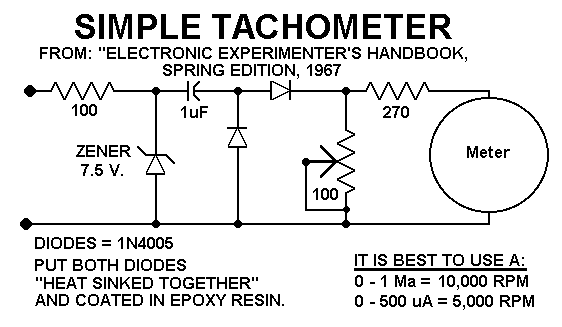

How Simple do you Want?
Gary
looks like a charge-pump?
For Those Beginners here, here is a Simple Explaination:
The 100 ohm reaistor and Zener Stabalize the DC Voltage.
The 1 uF Cap allows the Pulses from the coil to pass through and get rectified by the two diodes.
The pot limits the DC signal going to the volt-meter. (comprized of the 270 ohm resistor and the meter.)
I Recommend a Minimum 1 Watt, 100 Ohm Resistor and a 5 watt Zener.
Been Using it for Years and it Works Very Well.
