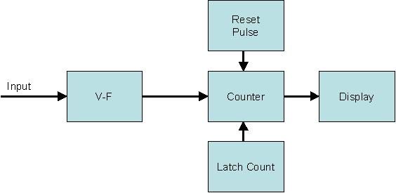

I was thinking of implementing a Voltage to Frequency (V-F) convertor followed into a counter that is configured for a specific reset/latch period?

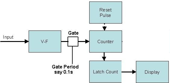

The V2F's will run at 100kHz is you want a 0.1Sec refresh rate for the display.
The gate is a logic gate that is opened for 1sec [or 0.1sec], during the 1sec period a counter is clocked with the pulses from the V2F. After 1sec the count is transferred to the display buffers then clear in say 100uS.
The gate/count then resumes....OK.?
To clarify the concept please refer to the following figure
Thanks Eric, yes that clarifies things. I will try to implement something along this concept.

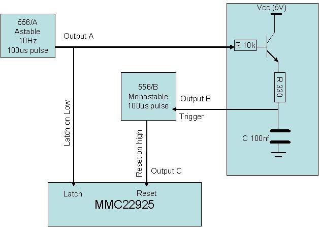

Okay... so I have managed to source an awsome old IC the MMC22925 This is a 4 digit counter IC with multiplex display driver supporting 4 digit display.
SO... based on previous. I need to latch the value to the display and reset (refresh rate) the count. I have come up with this circuit concept.
:D excuse the epic artwork :D

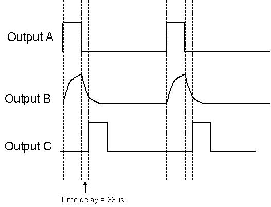

I need to latch the counted value by supplying a low signal. even though I hold the signal low it will keep the value when the signal went low (falling edge triggered)
however Once latched I need to reset the internal counter, BUT reset needs a small time delay after a latch so I implemented a capacitor timer :D to cause the 556B to trigger later on falling edge of capacitor.
The capacitor is designed with RC = 33us so it will charge competely in the 556A output high via transistor (2N2222 acting as a switch).
When 556A goes low the capacitor will discharge and trigger the 556B in 1RC time (33us).
This will inturn output our reset pulse.
this should hopefully work?

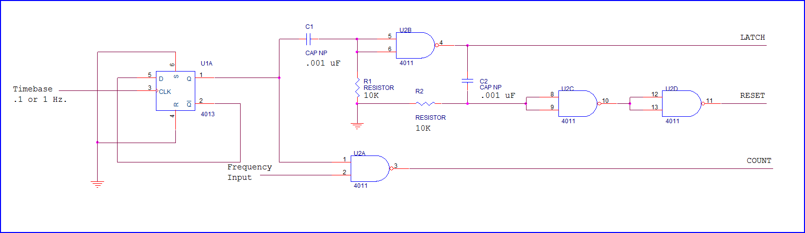

Your Latch/Reset signals have to be synchronised to the 0.1s [0r 1sec] pulse frequency input gate.
So gate open for say 1second, accumulate a count, end of the 1 sec gate Latch the data then reset the counter, then reopen the gate for the next measurement.
This is exactly what the above described circuit does... It has a period of 0.1 seconds and uses only a few microseconds at the begining to latch and reset. The majority of the period is used to count.
The latch/reset signals cannot be syncronized as the chip requires a small "settling time" between these signals.

I also did one in the early 80s and as MrAl mentioned the chip used was a FV9400 which could do Frequency to Voltage or Voltage to Frequency. I then used a pair of BCD Counters (3 Digit) that were MC14553 chips and the display drivers were MC14543 chips. The exact circuit ran in the old Radio Shack Engineers Notebooks 1 & 2 by Forrest M. Mims III.
The little circuit that took care of the gate and latch signals was like the image I am posting. This should be what you want to get going. I also hope it works as trying to upload files from work on a secure system doesn't always work for me. If not I'll post the circuit later.
