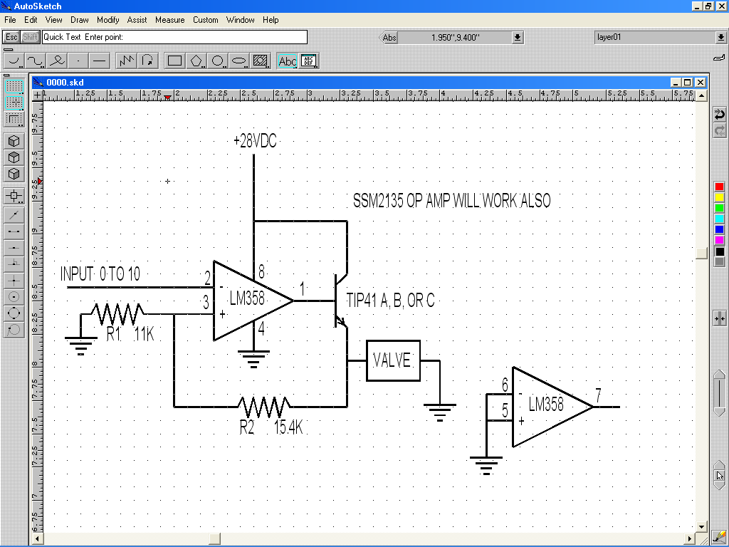

I have an analogue output card that I use with an s7/300 PLC that is 0-10V and need to drive a proportional hyraulics valve that works 0-24V
The valf says maximum 1amp and the circut breaker for the output card is also 1amp.

This is a circuit that will do the job:

The system works as Nigel Goodwin has described,
The varying voltage supply to the valve controls the restrcition over it controling the flowrate that changes the speed of the actuators in the system. Just a proportional valve only a relay and springs no motors or such to control the opening.
with 0 to 10V I can only open it to half way that causes the machine to move slowly.

The circuit Russelk posted will do the job!, and was similar to what I had in mind.
