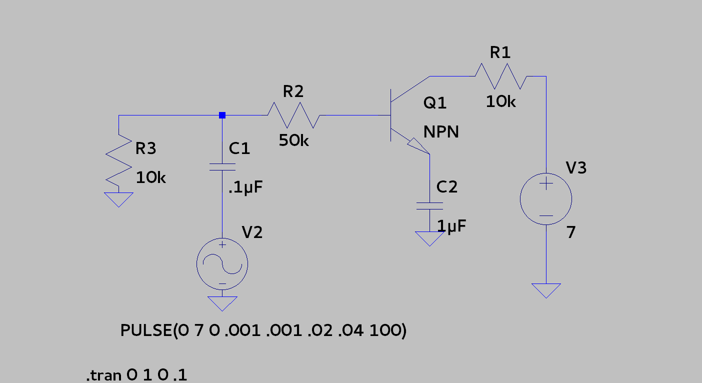

Is there a simple way to cause a voltage to increase according to the number of pulses the input has seen, irrespective of pulse width? I tried simulating charging a capacitor from a square wave input, but the voltage built up due to the time constant, not the number of pulses, so now I'm a bit stuck. Needs to be quite simple or it's not worth doing; I'll try something else. Any suggestions?
The purpose of this is to use a linear optical encoder to show how far a moving part has moved, driven by small motor (actually a CD drive head mechanism), so I don't want to add the extra load of a potentiometer to it. The idea is to produce a voltage change which can be used for linear feedback. End stop micro-switches will reset it if the part overshoots. No need for good accuracy, so long as it can track an input pot's movement.

Better than what I just came up with. I was trying to go for something just using a few discreet components. I just had another play and came up with this, it does one half of what I want. I'll look at low res DACs, though.

In analogue you could use a 555 to generate an exact pulse each time you geta trigger, use the o/p from the 555 to gate a current source which then charges a cap, each pulse will charge the cap a similar voltage each time, if the votls is regulated you could just use a resistor there will just be a bit on non linearity.
Instead of end stops you could use a resstor/transistor to detect overcurrent on the motor and reset the cap with that, no microswitches.

picbits - looked at that before. F-V isn't what I want. I need to turn approximate position, given by the number of pulses, into a voltage. As long as it tracks, accuracy isn't important.
MikeML - the original idea was that it would reach some preset voltage, and reverse itself, so the voltage would start going down instead of up. But it's a flawed approach, the reversal needs to originate from the controlling device (a pot on a foot pedal). So a reset (or set, I suppose) only occurs in the event of overshoot.
dr pepper - a more precise version of what I posted above, then (where the output voltage is from C2, btw). Ok trying my existing simulation with a constant current. Horribly slow...
