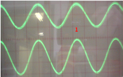

Results
The circuit was now tested with the load and had the following settings:
Frequency =1.5 KHz.
Input signal was set at 50mV/DIV for pic 1 ---->100mVp-p
Output signal was set at 1V/DIV for pic 1---->3Vp-p
The input signal is the top waveform. The output signal is the lower waveform.
The signal at the output had an amplitude of 3Vp-p. The gain was calculated to be 30V/V while the predicted value was 30V/V.
The input signal was then varied from 10 kHz to 20 kHz. The amplitude of the output waveform decreased. The gain also decreased as the frequency was varied from 10Hz to 20 KHz. Hardly any distortion was seen.

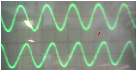

At 10 KHz the following output was observed on PIC2:
At 10 KHz the amplitude of the output waveform was 2Vpk-pk. The gain was 20V/V.

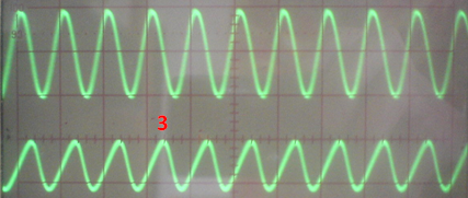

At 20 KHz the following output was observed on PIC 3:
At 20 KHz the amplitude of the output waveform was 1.2Vpk-pk. The gain was 12V/V.

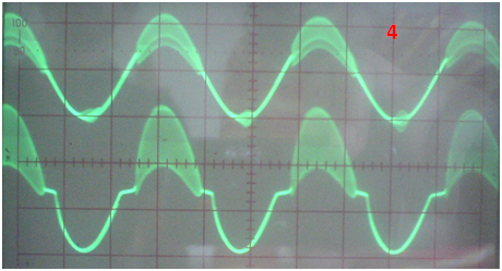

PIC 4
To observe a class B output on the oscilloscope, the Vbe multiplier transistor was shorted out between its collector and emitter. The circuit was now tested without a Vbe Multiplier and the oscilloscope had the same settings as before.
Crossover distortion was viewed on a scope in the form of a ‘kink’ in the output curve as seen above. This is a characteristic of class B Mode.
When the circuit was tested with a Vbe multiplier and the potentiometer was adjusted, the output curve smoothed. By adjusting the potentiometer in the VBE multiplier, the base bias voltage VBB is changed. This changes the quiescent current that flows. By adjusting the quiescent current, the class of the amplifier changed. β is not exactly known, so there is no way to choose specific resistors to bias the transistors for a certain class. Therefore a potentiometer was used.
Any clue why the input signal is distorted? Does it have to do with feedback and slew rate?

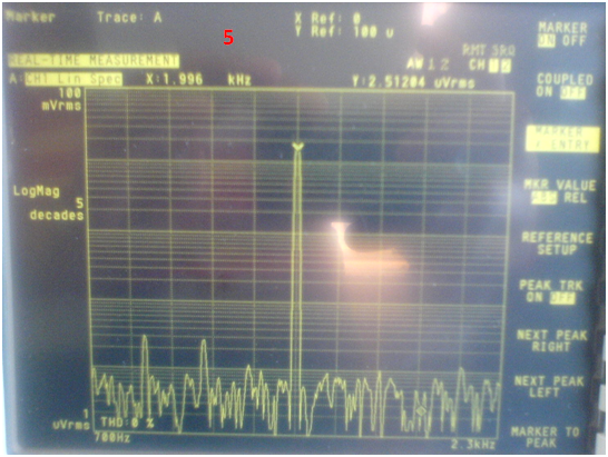

The next test was to measure the total harmonic distortion (THD) of the amplifier. Total harmonic distortion is measured in percentage terms and is a representation of the distortion of an audio signal at full output level. A clean sine was required to be inputted into the circuit. A function generator will not be able to generate a clean sine wave therefore a spectrum analyzer used. The input sine wave was set to a fundamental frequency of 1.5 kHz & 25mVpk. Thereafter harmonic markers were placed on the signal. The THD function that the spectrum analyzer had was implemented. The THD measured was 0% as seen in the figure below. This was an acceptable value since no distortion was visible on the output waveform. THD should be around 0.01-0.1%.
2 & 3 are rather distorted - if you can see it on a scope it's really bad.
Is it distorted more at higher(20KHz) or lower frequencies(10KHz)?
I would say 20KHz since the gain lowered, right?
