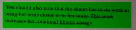

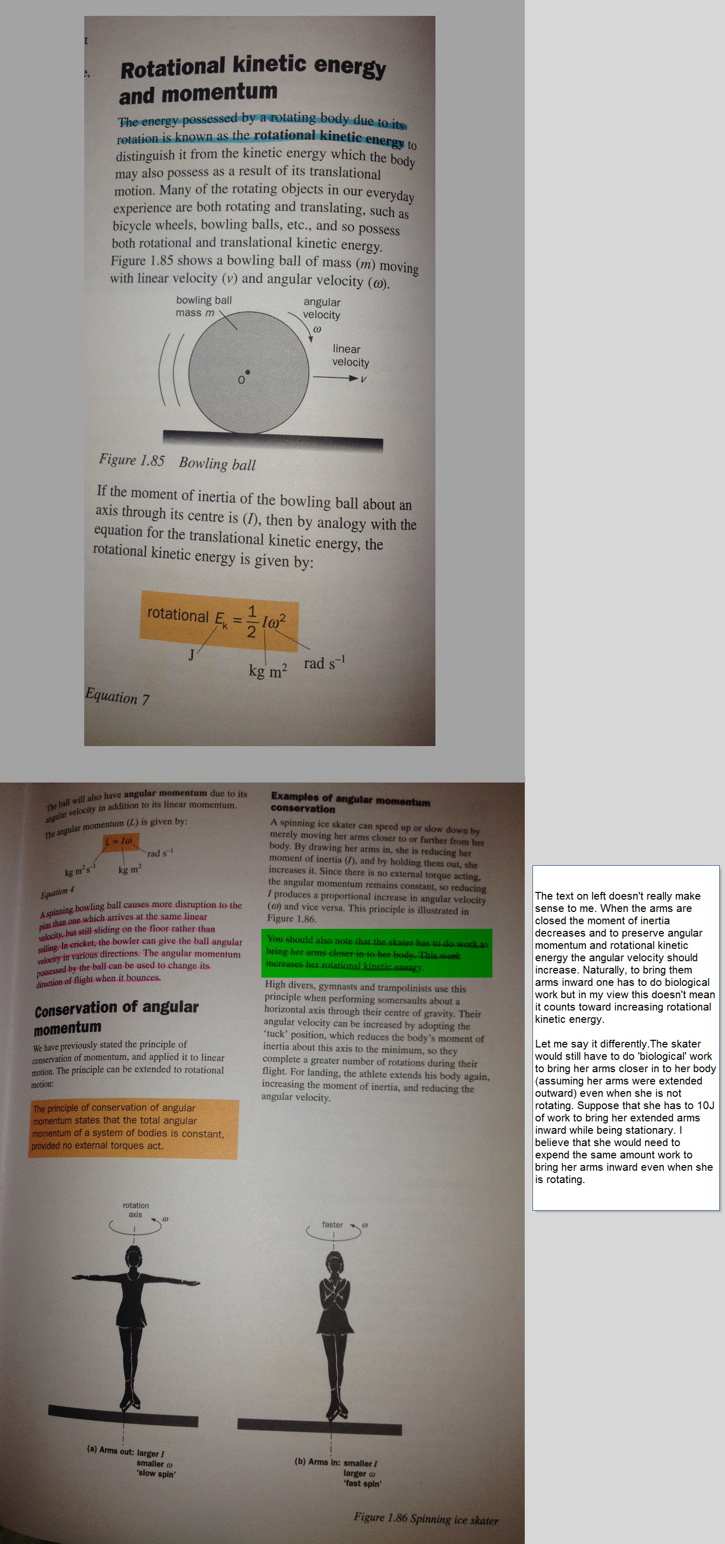

Please have a look here.
The text on left doesn't really make sense to me. When the arms are closed the moment of inertia decreases and to preserve angular momentum and rotational kinetic energy the angular velocity should increase. Naturally, to bring them arms inward one has to do biological work but in my view this doesn't mean it counts toward increasing rotational kinetic energy.
Let me say it differently. The skater would still have to do 'biological' work to bring her arms closer in to her body (assuming her arms were extended outward) even when she is not rotating. Suppose that she has to 10 J of work to bring her extended arms inward while being stationary. I believe that she would need to expend the same amount work to bring her arms inward even when she is rotating.

Just a quick note...
If you have a mass on the end of a string with a spring scale tied in the middle of the string so you can measure the pull force the mass exerts as you hold the other end of the string, when the mass is still you will register the force from the weight of the mass only. But when you twirl it around in a circle you will measure more force because it is trying to fly away from the center.
Likewise, if the mass on the string was on a frictionless horizontal plate you could move it easily from side to side, but if you rotate it in a circle with the other end of the string at the center, it will be harder to pull in toward the center and easier to let back out to the original rotation diameter.
Thus the girls arms are harder to pull in toward her body when rotating and easier to let back out to full length to her sides, which would be much different if she were standing still. In fact, there may be some speed where she doesnt even have the strength to pull her arms in, although this might require a rotational speed faster than humanly possible.

Hi PG, it's been awhile.
Try your own experiment. Stand still with your arms extended. Do that for a few hours, and your arms will probably drop from their own weigh. If you are spinning; however, it requires work to more your arms in. You can test that with socks and a hardwood floor. I am not sure of your exact question, but the section in green that you have highlighted is correct.

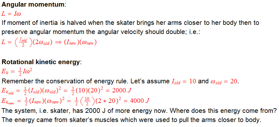

Thank you, MrAl, John.
So, according to both of you the text in green is correct and the skater has to expend a certain amount of work to bring her arms closer to her body and this expended work get transferred to her rotational kinetic energy. Right?
That certain amount of work is not fixed and would vary depending upon her rotational speed before she starts bringing her arms inward. For example, she will need to do more work to bring her arms closer to her body when she is rotating at 160 RPM than when she was rotating at 80 RPM. Right?
Suppose that before the skater decides to bring her arms closer to body, her rotational kinetic energy is 120 J and that energy should be preserved. Now she starts bringing her arms inward and hence she expends certain amount of 'biological' work/energy for this purpose. Let's suppose that the expended 'biological' energy/work is 30 J. Once she has completely brought her arms closer to body, her total rotational kinetic energy should be now 120+30=150J. Most probably what I'm saying is not correct but I believe that now you can see better where I'm having confusion. Thanks.

I don't see where the confusion is. The rotational kinetic energy is proportional to the moment of inertia and the angular velocity squared. If the skater retracts the arms so as to reduce the moment of inertia by one-half, then the angular velocity will double, and the square of the angular velocity will quadruple. The one-half moment of inertia and the quadruple angular velocity will double the rotational kinetic energy when the skater retracts. The skater's muscles will have to provide the needed energy to do the maneuver.

rotational1aa-jpg.92859
Do I make sense? Kindly let me know. Thanks.

You are repeating what I said previously.
Yes, your posting paved the way for understanding and I only had to put everything in mathematical order.
Now let's imagine the situation when the skater decides to extends her arms outward again. Her angular velocity is supposed to be 40 and moment of inertia to be 5. Once she has extended her arms outward completely, her angular velocity would be 20 and moment of inertia 10. Her kinetic energy would be 2000 J. But when her arms were close to her body, her rotational kinetic energy was 4000 J, so where did the rest 2000 J go? I belive this energy go into pulling her arms outward. In other words, she didn't have to do any work to extend her arms, the arms got extended on their own using system's 2000 J of energy. Is this correct?

Yes.

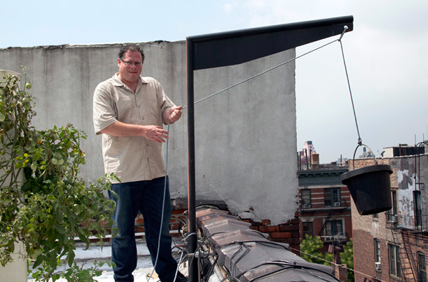

Suppose that a bucket full of water is let to fall from the roof of a 5-storey building using the pulley system like the one shown here. By the time, the bucket is just going to hit the ground, the rope is pulled back so that the bucket doesn't touch the ground, and this is done successfully. Naturally, the bucket had a significant kinetic energy before it was stopped by a human, where did this kinetic go? I understand that human muscles (or, biological energy) were used to stop the bucket movement but I can't clearly see the transfer of bucket's kinetic energy into any other form? Please help me with this. Thanks.

Force through a distance equals energy or work. The rope was pulled on with perhaps a hundred pounds of force by the human with friction on his hands (ouch) or hand under hand grabbing. It took perhaps 10 feet before it stopped. So the kinetic energy that what was dissipated by the human's muscles and blisters was 10 times 100 or 1000 ft-lbs.
Forget the blisters and let's focus on only dissipation by the human muscles. How does this dissipation take place? I can imagine that the bucket will try to pull the arm outward and the muscles will counteract this pulling. To counteract this pulling the muscles would basically be investing 'biological' energy... Kindly guide me. Thanks.

Yes, each arm will be exerting a force on the rope while extending the length of its reach. So force through a distance equals work, right?

As far as the original question goes, I'd like to add some further insight. I think that what is answered above is basically correct, but keep in mind that the task of stopping an object in this way is a very complicated thing to analyze and to figure out exactly where and how the energy is dissipated.
Consider this thought experiment. Instead of a person stopping the bucket, imagine that a weight/mass is used to stop it. A block of steel, for example, could have a eyehook that the rope freely passes through. Then a knot in the rope can be placed at the proper place so that the knot stops at the eyehook and catches the steel block on to the rope and stops the bucket (because it is heavy enough).
First we have to realize that the rope itself has stretch (spring force) and energy loss (damping force) and the damping in the rope eats up some (probably most) of the energy. If the weight is very heavy, then it will not get lifted off the ground, and the stopping of the bucket will be a very abrupt event. But, the main place the energy goes (assuming the bucket does not shatter due to the stress) is basically in the damping of the rope.
Also, we could imagine that initially the weight gets lifted off the ground and that potential energy sucks up some of the energy, but then the weight will probably go back down afterwards. This might give a less abrupt event, buy still it is the damping in the rope that mainly dissipates the energy. The kinetic energies and potential energies of the bucket and weight come into play, but in the end, the bucket is closer to the ground and the mass is in the same place and there is no kinetic energy. Hence, the potential energy loss of the bucket must have been dissipated, and the rope is the place where the damping occurs. Consider that if the rope has very low damping, the bucket will oscillate up and down for a long time while the dissipation happens gradually. If the rope has high damping, then the bucket will stop quickly.
So, in some sense, the person can act like a heavy weight and do the things described above. However, since humans are intelligent, a person can use muscles and energy dissipation in his/her own body to change the way the bucket stops. In other words, a person can take up some of the dissipation that the rope would normally have to provide, and in doing so, can provide a less stressful and less abrupt event in stopping the bucket.
