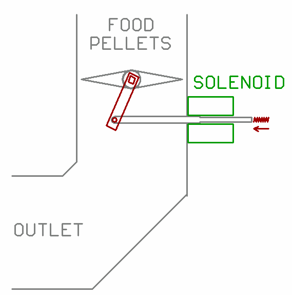

Hi Mark,
here is a suggestion for the mechanical part of the feeder.
The "throttle" should be activated according to feed time and amount of food to pass (timed activation).
The amount of food is important not to exceed the maximum allowable weight of the rabbits for exhibitions. (mine: Blue Vienna (Blaue Wiener) at max 4.5kg)
You might use an extending or retracting solenoid with its zero position retained by a spring.
It's easy to do with a few tools and should not have mechanical malfunctions even if some pellets are jammed between the throttle and the feed line.
Boncuk

May i ask in this thread how to do the mechanical part, from the pic, i still don't understand how to made it
