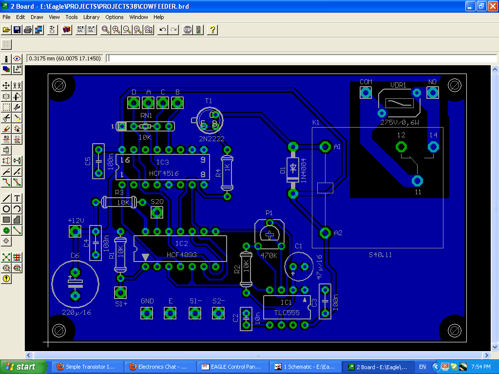

Hi Mark,
since your are going to use a different BCD switch (panel mounted) I omitted all switches as they were in the first design.
You will certainly use heavy duty push buttons as well and also panel mounted.
Here is the second design. Board dimensions are 3.6X2.3".
Boncuk

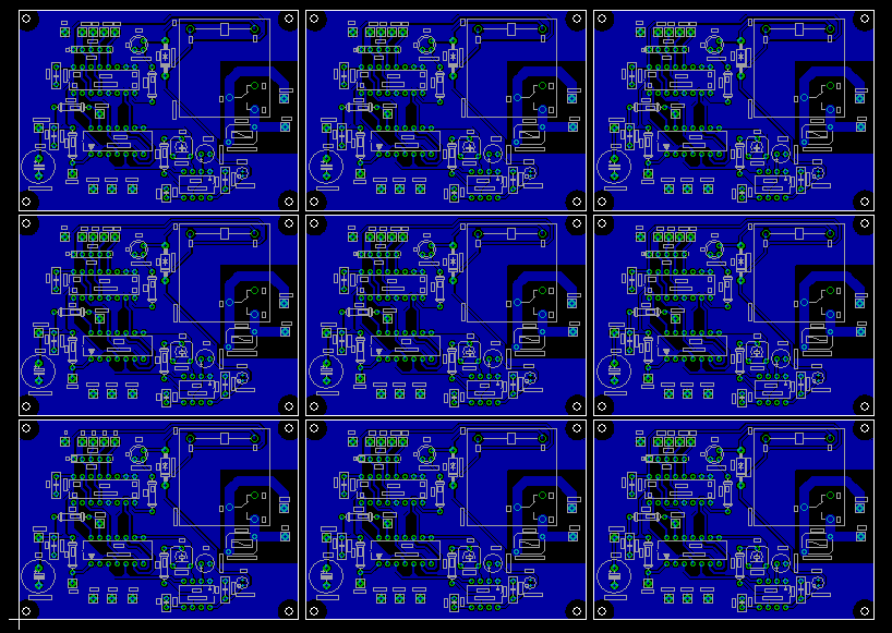

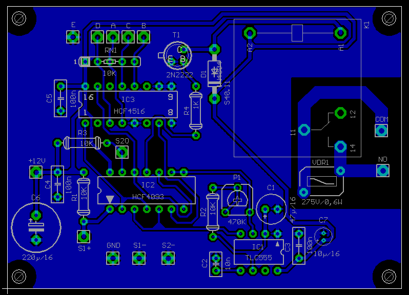

Hi Mark,
I revised the board layout and the new dimensions are: 3.2125X2.3" (81.5975X58.4200mm)
All large solder pads will be used for external connctions.
I made an online calculation for 9 boards of the same size with 1.5mm distance for cutting.
The board will be FR-4 base material with 35µm of copper layer, single sided. Finish will be HAL (Hot Air Leveling) with leaded solder. If you want RoHs conformal finish you might select that one. Solder stop mask will be green and no silk screen print on the component side.
I have added one more electrolytic cap near the timer IC to make it work reliably. The relay has a VDR (voltage dependent resistor) instead of a snubber network. It has turned out be better than the latter for inductive loads.
The price for nine boards will be €64.08 (sales tax exempt)
PCB manufacturer is Bilex in Sofia/Bulgaria. I get all my boards made there and the quality is very good.
Here is the URL: https://www.bilex-lp.com
Attached is the latest revised PBC design. If you go along with that design I will make one large PCB with 9 parts. Ordered as one board Bilex cuts them to size without any charge if cutting is not ordered. For any questions concerning your order contact Mr. Hristo Ginov. He is the boss of the company.
Regards
Boncuk

Bonuk,
Thank you so much for your help - a few further questions if thats ok?
What thinckness FR4 base should I select - what would you advise?
Also - what file do I attach to the quote? do you need to send me a file to my personal e-mail, or will a copy of the picture do?
Regards
Mark

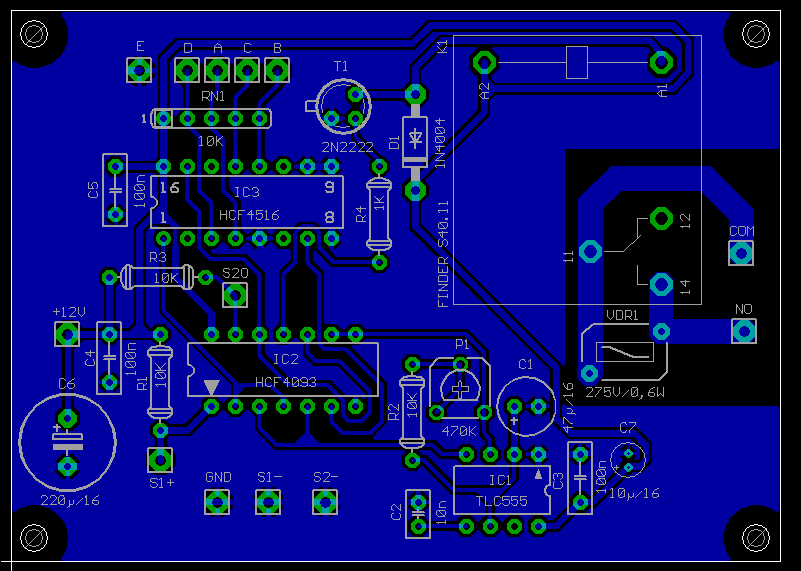

Boncuk:
You do very nice work. T1 has the silkscreen over the hole. I know your not having one put down so it really doesn't matter.
Hi Mark.
PCB base material should be selected 1.55mm thickness.
If you have decided to use Bilex for manufacturing you'll just send the original Eagle file with the suffix *.brd.
Bilex rejects any self made Gerber file since they are doing their own stuff with a Gerber photo plotter not contained in the CAM-job of Eagle.
Also concerning the price for the boards Bilex seems to be much cheaper than the manufacturer you had planned for.
Nine boards of 3.4125X2.3 cover an entire area of 68.6875 square inches includings cutting gaps. At a total price of €64.08 one square inch will cost €0.939.
These are the values to put in for online calculation (select the Union Jack at the top for English):
Board name: COWFEEDER
Dimensions: 249.4X177.8mm
Processing time: 5 work days
Number of layers: 1
Number of boards: 1
PCB material: FR-4
thickness: 1.55mm
copper layer: 35µm
Finish: leaded solder (no RoHS)
Solder stop: Bottom
Position print: no
I probably made an error when calculating yesterday. Today the price of €46 turned up.
And this is what you'll send to Bilex:
If you don't wish any changes I'll send the Eagle files right away.
Regards
Boncuk

Boncuk:
Hi KeepItSimpleStupid,
that might be your impression. The "silkscreen" over the holes of T1 is located on layer51 (tDocu).
Layer51 is not printed on the silk screen. It's there to assist when populating the board.
This is what the silk screen looks like without layer51.
Regards
Boncuk

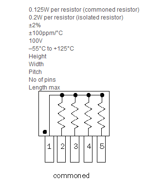

Hi Mark,
This is the resistor network type for the select switch, the RN 10K Commoned.
https://www.rapidonline.com/Electronic-Components/10k-2-4-commoned-Resistor-Network-63-0265
Hans asked me to find it for you
Image.

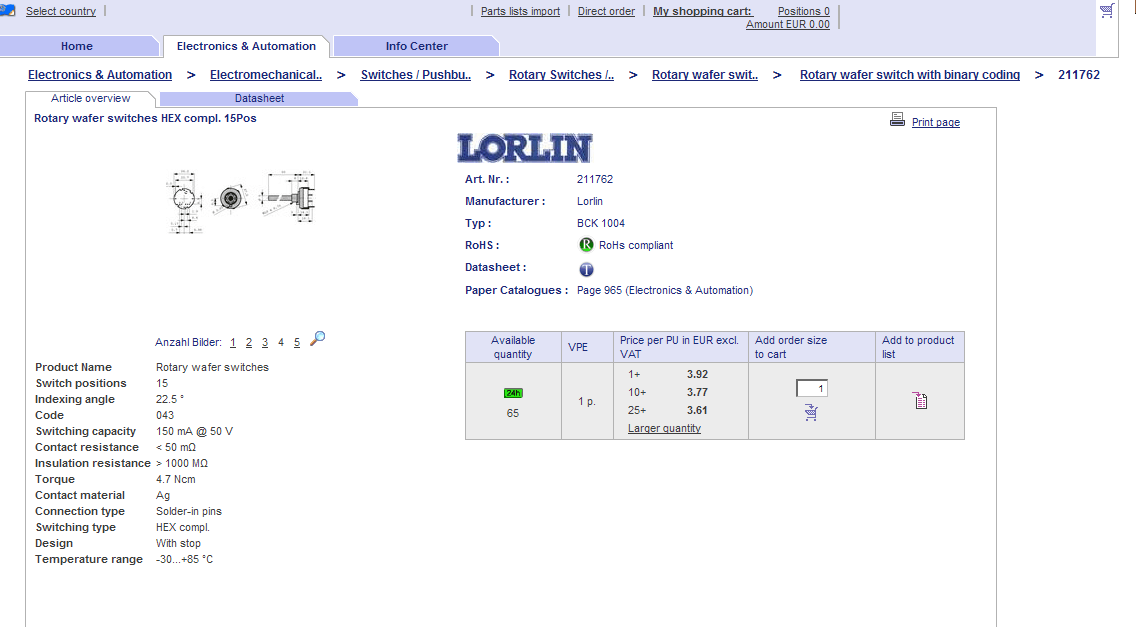

Is there an alternative rotary switch for the Lorlin BCKS1004 - its proving hard to source?
hi Mark,
Farnell and RS comps stock Lorlin rotary switches type Lorlin BCKS
Contact www.lorin.co.uk by email using their 'Contact Us email' and ask them for a known stockist, for Lorlin BCKS1004 043
If you have no success we could suggest an alternative manufacturer.
Eric
In the mean time I will keep looking.
EDIT:
http://www.distrelec.com/ishopWebFr...1&node=DC-22221&artView=true&productNr=211762
Eric,
Have been in touch with Lorlin already - they aren't too helpful - farnell and RS dont stock the BCKS1004 043 type - and would need to be specially made, I am being quoted for it to be viable a manufacturing run of 100 pieces - a alternative would be appreciated if you can see anything similar and suitable
Regards
Mark
Have also seen that other website you suggest, but when you get into it - it wont let me select the UK as country of origin for some reason, only poland, slovenia, and slovakia!!
