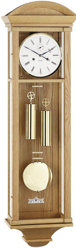

However here is another mechanical suggestion:
Regulator clocks are normally driven by a pendulum which converts linear movement into rotation using a tooth wheel with the teeth looking like shark fins.
The pendulum drives a pushrod which advances the toothwheel with every stroke. Mounting that tooth wheel to the rotary dispenser you might use as many food "cells" as there are teeth on the wheel.
Here is an image of a regulator clock.
It's a reproduction of the famous "August Tasche" regulator built in Vienna 1850.
