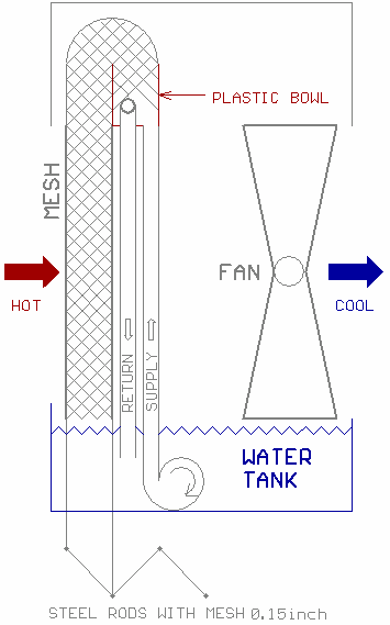

Hi Brownout,
here is a design not requiring filtering which works well in my house.
Use fabrik mesh arranged in a zig-zag pattern for largest and most effective surface of the mesh.
An aquarium pump capable of 150-300l/hr will suffice for effective cooling.
The mesh has to be dipped in a bowl of water beeing filled by the pump with an overflow opening slightly elevated to feed excessive water back to the tank. Capillar force will make the entire mesh soak with water which evaporates in the air stream.
Use a fan capable of 1,000 (50cft/m) to 3,000 (150cft/m) cubikmeters of air flow per hour. The mesh shouldn't be tighter than 0.15inches because of higher air flow losses due to increased resistance.
Besides cooling the air effectively that device also takes care of cleaning the air, and has the advantage of no messing around with clogged up spray nozzles.
Regards
Boncuk
Thanks for your detailed suggestion, Boncuk. When I lived in the desert Southwest, we used a very similar system to cool our homes.
