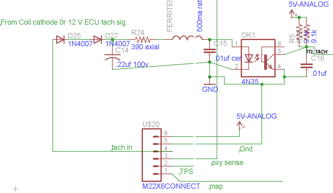

Stated as simply as I can in one sentence, my issue revolves around being able to get a "clean" rpm signal that my after market; rpm, air/fuel ratio, temps and throttle position data logger can accurately interpret.
The engine in question runs a multi-toothed magnetic reluctor trigger wheel with missing teeth on one section of the wheel that provides crank position information to the ECU. So this signal is not really interpretable by the data-logger.
See figure 1.4: **broken link removed** represents the signal this set up generates which the ECU can interpret just fine but this means scattered mumbo jumbo to the data-logger.

1) I've ordered from the US an Autometer tach signal generator for coil-pack/distributor-less ignitions, that when wired in series with coil (+) reads the current ebb and flow to produce an apparently accurate tach (-) signal. This may be enough for the dat-logger to read.
2) However near future plans will eventually require a 0-5 hall-like tach signal so I need to convert this (-) pulse from the Autometer signal generator into an emulated 0-5v trigger signal.
That is what I need assistance with - a circuit to produce this 0-5v square wave signal from the Autometer (-) tach signal...
Does anyone have any advice or design ideas for this problem?

I did this for our race cars and an intake motor control and digital dash I made. You can likely adapt the circuit to work off of your coil. They will provide a perfect 0 5Vdc square wave output. One is a divide by two so beware.

TTL tach conditioner
Here's another that's opto isolated for max reliability.

Thanks very much for that - very very helpful and useful info...
The ATM 9117 referred to in the Eguage Installs link is exactly what I've ordered.
The circuits in Tach Circuits.pdf look like they're exactly what I need to drop on the back end of the ATM to produce the 0-5 signal.
So I'll call that problem solved and head down that path - thanks once again...
