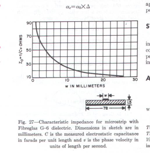

I am designing a new PCB with a LR8905 GPS reciver on it, this GPS engine has a pin for the antenna and it has a note saying "The circuit line must be matched to 50ohm impedance or resistance"
Now I'm not a RF or analog guy, I can program a PIC and throw a digital circuit together, so my questions id how do I make sure my PCB track is OK. is it as simple as making it have 50ohm's resistance?
The PCB track is essentially a transmission line. To get maximum power transfer and with many circuits, to get it to function properly (or at all) the output must look like 50 ohms resistance. In order to do that the antenna or load must look like 50 ohms resistive. The problem - you need to connect the output to the antenna via some means. That "means" is the transmission line. Typically transmission lines are coaxial cables. They are designed to have a characteristic impedance of 50 ohms - or some other standard value. Tracks on PCBs can be designed to have a characteristic impedance.

It's not the resistance, it's the impedance - as I mentioned before, with coaxial cable it's set by the ratio of the inner and outer conductors - I don't know how you would calculate the impedance of a PCB track?. But, presumably?, it's the relationship between the conducting track and any nearby ones?.

I have seen explanations of PCB track designs that would enable you to etch the right tracks but I can't put my finger on the websites. The PCB thickness, copper thickness/width and PCB material all play into the calculation. I don't recall it being all that difficult to calculate. The challenge would be integrating that into the rest of your design. I did a quick google on "PCB transmission line" and some interesting sites popped up.
If I were in your shoes I'd be inclined to do as Nigel suggested and use a short piece of 50 ohm coax - or just etch something that you think will work. Try it an see - keeping this as a future improvement area.
The term for a transmission line on PC board is: microstrip. You can try Googling for that. A two sided board is needed for the "ground plane".
This chart is from the ITT handbook:

It clearly states, in the datasheet, that "The circuit line must be matched to 50Ω impedance or resistance". The diagrams on pages 12 onwards also show it!.
The graph posted above shows you the doublesided PCB details required, it looks about 3.8mm wide for 50 ohms.
