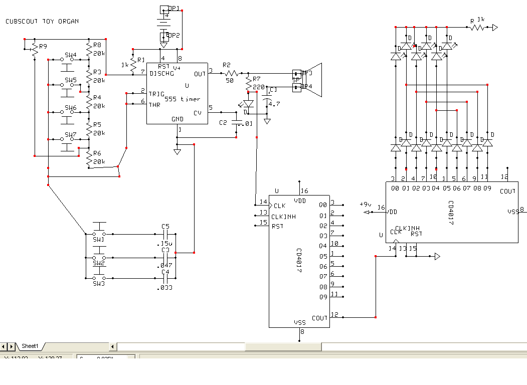

any easier way to divide by say 12 or ?
MrDEB
using attached schematic, the 555 output depending on switch combo, anything from 95 - 1064 hz.
divide by 10 we get 9.5 - 106hz
at 106 hz the leds would be all on or at least look like it.
thinking a 4013 but trying to keep parts count down.
the 555 circuit is already built. the cub scouts had / having a ball assembling and making "music"
want to add some FLASH
the basic knight rider circuit would do the trick.
any suggestions on simpler way to do this.
even considering a PIC but only justy starting out getting feet wet and knowing basics of SWORDFISH. would like to use a smaller chip (only have used 18F series)
any takers or suggestions.

Use a 4013 14-bit counter as a divider. You can tap-off whatever divide ratio you want.
I think you have the wrong chip?
A 4013 is a duel D flip flop
Wonder if say a 4059 can be subed for the 4017??
Yes, somehow I wrote down the part no. the op was using.
The 14-bit counter is a 4020.

Whatever counter you use, you need to drive it's clock input from pin3 of the 555 and not from the LED.
oups your right. my bad. I connected to wrong side of LED.
in the schematic I failed to remove the 50 ohm resistor connected to pin 3 as well. the unit is not real loud anyway as the speaker is 27 ohms instead of the listed spec of 8 ohms.

For a divide by 12, use a 7492 , its a divide by 12 ic.
Am thinking that divide by 10 is adquate seeing how I only go up to 1064hz or there abouts.
divided by 10 =106hz then sending the 106hz into another 4017 with 6 LEDs connected to 10 outputs means each LED is flashing at 17 hz (I think?)
