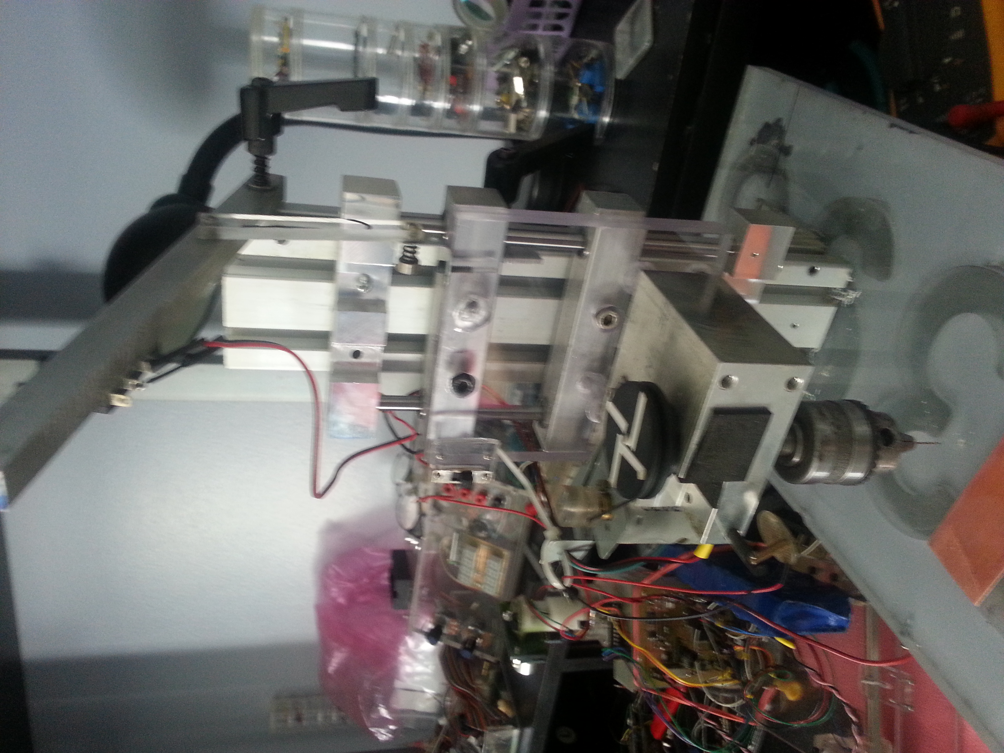

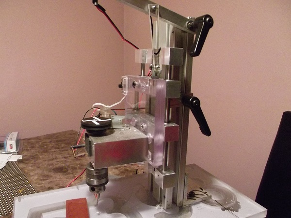

20130630_123454.jpg I drilled a pc of threaded rod for the shaft to thread into the chuck, I went through alot of chucks I tood off of cordless drills to find one w/ "very little" runout. I coupled the motor to shaft w/ O ring which is supported by 4 bearing. the "ways" are printer shafts.

thx. It's about 8" high, amazing what can be made if you have a need and a good supply of junk and really cheep:) I had a stepper drive for the feed but I like the "feel" when drilling w/ small bits.
sorry, I never mentioned the motors. They appear to be just like the motors out of a printer, some use alot of amperage and really spin fast.

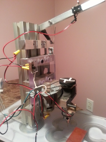

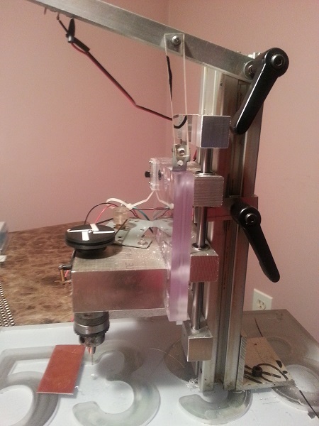

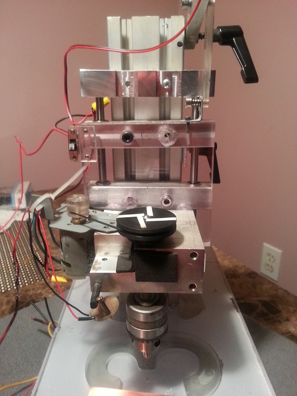

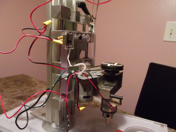

Hope this size is better?
high power white led is on round pcb by chuck, a momentary switch on up/down lever, on/off switch on back plate, quill stop on lower black handle.

Great photos JoeG thank you!
That is a pretty serious looking PCB drill.
Mine has a siliar sized electric motor, but with the pin chuck on the end of the motor shaft. Yours looks to have a 1:3 reduction gearing? I know that allows some larger drill sizes, but is it still fast enough for the fine PCB drills ie 0.8mm?
thanks, the motor really spins fast, I've used it w/ drills of .010" so far. at 12v it really goes to fast. Its also a 2 groove pully, smaller groove is on underside. the quill feed was neat but was just overkill :)

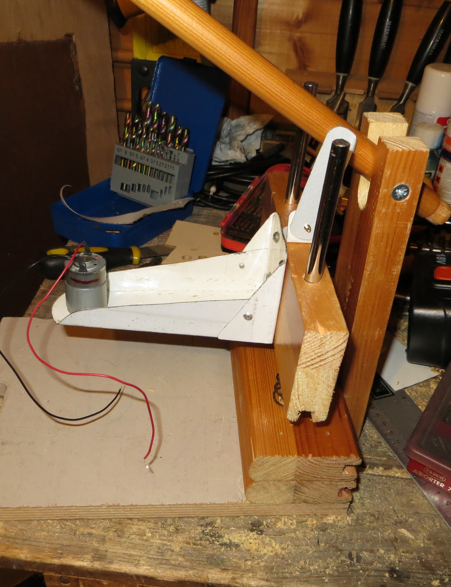

Threw this together today!
Not up to Joe G's standard, but I banged it together out of some wood from an old cot, a bit of old shop shelf, a rod from an old bird cage stand, some metal from the casing of an extinct tumble drier, 2 springs from some speed clamps that didn't clamp, and a very small bit of aluminium tube. The motor came from an old printer - I was surprised how many I have. I had to pick a small one because the chuck on order from eBay fits a 2.3mm shaft. I have to wait for it to arrive from China :(
Amazingly, the motor seems quite straight.

That's a simple and ingenious design Throbscottle. :)

I took photo's as I went, so when it's finished I'll publish an Instructable :)
Nice job using odds and ends, my first one was also made of wood, and chg'd as req'd. till I went overboard :) It also would be nice to see other's use of items.
Collet chucks arrived today. Nice little things, fit the shaft very well, run nice and straight. Ran the motor on 24v to get a good speed up.
