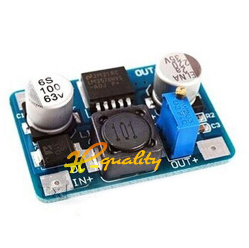

Re. the LM2576
Those are the basis of many of the cheap buck converter modules:
They are again not charge controllers.

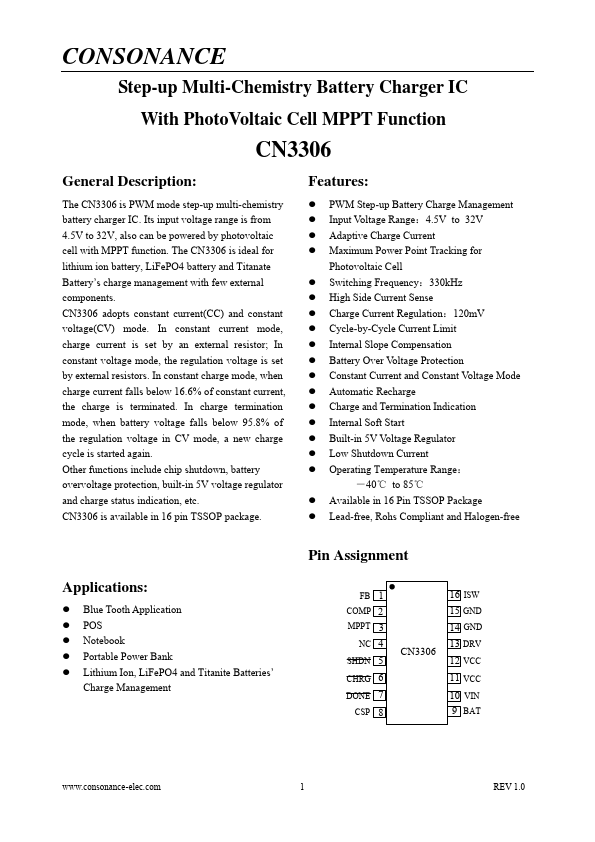

Ive been looking at the datasheet for this IC and it appears it should be up to the job, Im looking at the schematic in the datasheet and it appears the board layout is loosely based on the datasheet schematic.
Is there any component value I should check that could be limiting the output current?
The resistor value for Rcs appears to be for current sensing, this board appears to have a 60 ohm resistor, would changing this resistor increase or decrease the output current? I want to get the maximum current available and testing on my lab power supply shows that even in a situation where input current is plentiful, its only putting in about 1.2A. If i could get closer to the 2A thats advertised, that would be great.
If its just a simple swap out for a different resistor to change this, then that would be awesome.
In the diagram Rcs and Rsw are the current sensing resistors, for battery charge current limit and overall power limit. I'd expect both of those to be a fraction of an ohm?
60 Ohms in either position would limit current to small fractions of an amp.
Your right, its pretty low, my meter cant be that sensitive but its reading zero ohms.
Its stamped 060, i assumed that meant 60 ohms, but its not even reading as 0.6 the meter leads measure 0.3 ohms, and thats all I get when measuring it.
I see that pin 1 is supposed to connect to the battery for feedback voltage input, but its not connected on this unit, but I dont think its required for MPPT use?

0060 could well be 0.060 ohms (60 milliohms).
I commonly use 0.1 ohm for current sensing, which is less than double 60 milliohms.
I'd certainly suspect that 60 milliohms is the most likely value - basically you want it low enough not to waste much energy, and for the same reason not to dissipate much energy (to avoid needing a large resistor that runs hot). On the other hand, you want it high enough to drop enough voltage for your measuring system, which will usually include an opamp to amplify the voltage drop.
For an example:
For 2amps a 0.6 ohm will dissipate 2.4W, a 0.06 ohm will only dissipate 0.24W

OK, any reason that the charge current is so low then? Anything else I should look at?
Im getting up to 1.3A into the battery and its only drawing 1.7A from my power supply.
This IC is designed to handle up to 5 amps, but I only need 2 amps, If its possible to tweak this to get more power, it would be beneficial.

Do any MPPT IC's here look suitable?
Looks like development boards are available.
