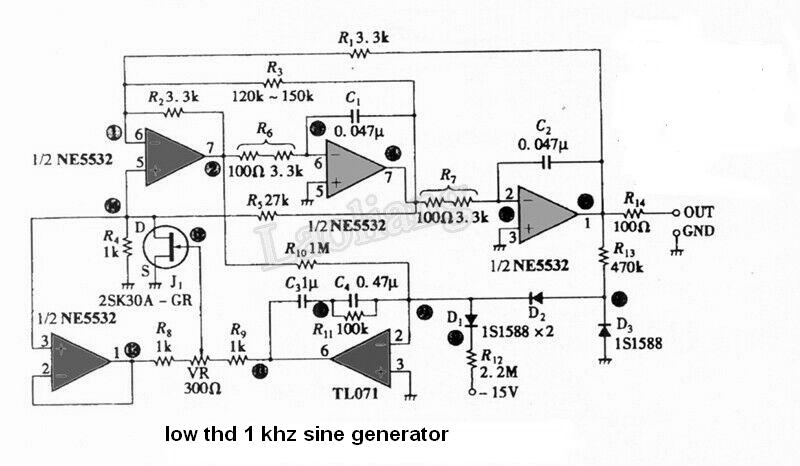

Any opinions or improvements suggestions about this low thd 1 khz sine generator ?
gaetan8888
Hello
Thank
Bye
Gaetan

For what purpose do you need a 1khz Low THD sine wave generator?
Also, the 071 could use a 100pF cap across pins 1 and 8 (check the datasheet).
Such devices are as much 'art' as 'science', and I recall that it's easier to get low distortion using a bulb rather than an FET in the feedback - from HP I seem to remember?.

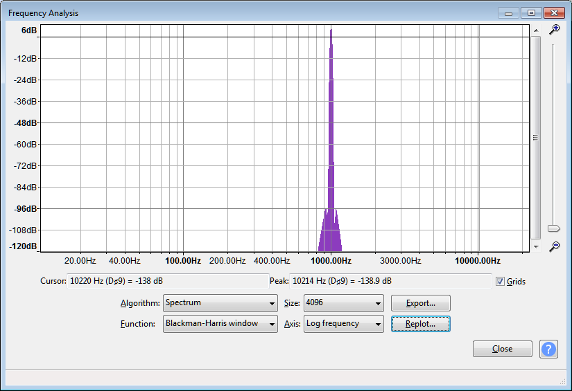

The key question is what is your spec for THD? -60 dB? -80dB? -100 dB?? then how will you verify it? If -60 dB, the solution to both could be a Software Sig Gen. and Spectrum Analyzer. Audacity.exe generate anything you can imagine and detect with AUX input.
Well that's not how you measure THD, it's in percentages (such as 0.01%) not dB's, and PC hardware is nowhere near capable of the requirements for decent quality audio measurements.
However, pretty cool thing Audacity - and would be VERY useful for less critical applications.
Yes of course, but Spectrum Analyzers measure in dB then you convert that to %THD . Last time I used an electret mic with tower Turtle sound card, I was surprised by the SNR and THD it recorded using Audacity. The mic also had a DC response with bias nulled. Let's see how much %THD is -120 dB for the waveform in memory.....
