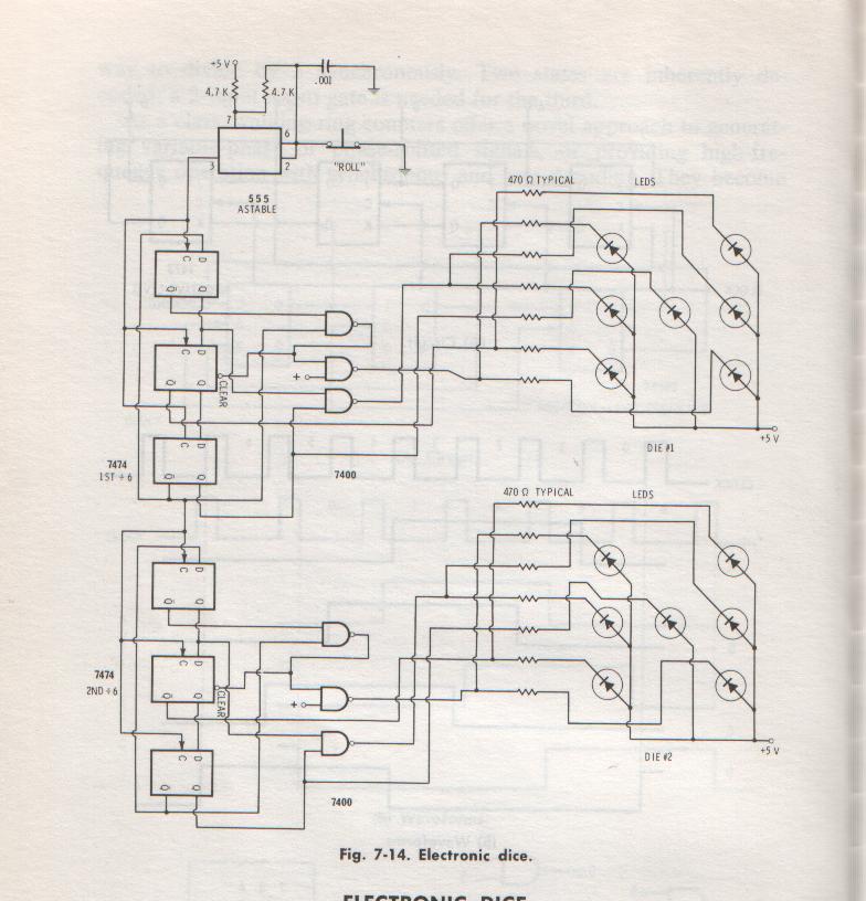

An old favourite still in use...Electronic Dice
[/img]
Tansis - just a bit of nit-picking - your diagram of the 555 doesn't show power supply or reset connections ( pins 1,4,8 ). I know it is usually omitted from logic gates, but for other ICs it is normally shown. And regarding the 'roll' switch - whilst it does work this way, wouldn't it be more conventional to put an NO switch between supply and pin 4?
Hello Phasor, well spotted.
I to used a more conventional circuit when I last built this, but perhaps a more elegant solution would be to use the spare logic to form an oscillator.
