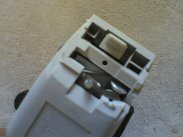

i have got this hair shaver which broke due to me dropping it. the plastic cover is broken s now it unrepairable can some one give me any idea on how to sue it in some hing else since the motor is lim(i guess). also is the motor inside a hair drier ac or dc. i usually dont feel comfortable working with ac.

please forward more details about the shaver.
- does it only work with the power cord connected to a wall outlet?
- does it really have a motor or just a vibrator?
e.g. Philishave use small DC-motors and three rotating blades, Braun uses vibrators cycling as fast as the mains frequency.

The linear motor in a shaver is still a motor, about all you can do with it is vibrate things, it runs on your line voltage so they're not excessively useful. The picture looks like a common clipper style shaver. You could crack the case open the rest of the way and pull out the main 'motor' coil, will make a nice high power large value inductor. The head is going to have some decent rare earth magnets.

Hot glue a scrub pad to that plastic piece, and use it to clean your bathtub.
