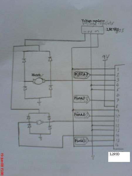

3v0 sorry,i forgot post shematics...i post now,but not very clear..you can check see got any mistake or problem with my circuit...Thank you very much in advance to all you guys.

I do not know what a PT2272 or PT2262 is.
You are going to want to start using a computer program to draw schematics. That will make them easier to read. For now take care to write clearly.
Are you stuck with the 16F84?
Are the 3 lines coming out of the reciever PWM? Are all three proportional?

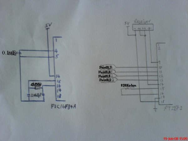

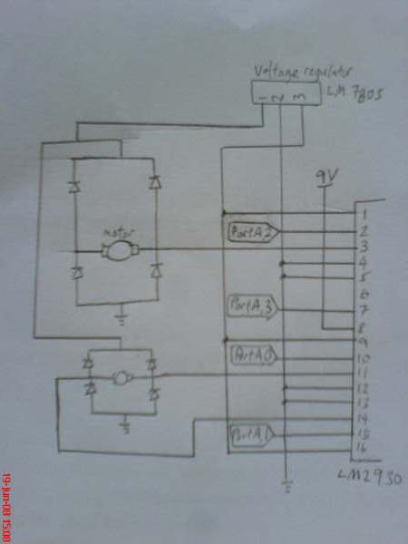

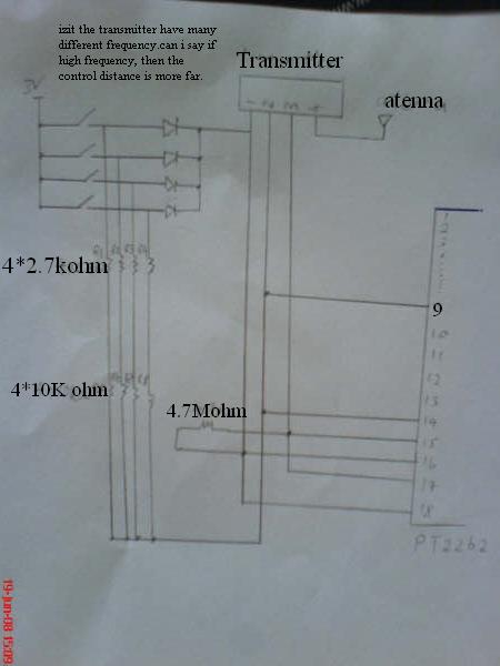

sorry 3v0,i given some wrong information.i post the new one..;)
PT2262 and PT2272 are pairs of receiver and transmitter.ya..i'm stuck with thePIC cz i don't how to write the program make it do the same work(using remote control and then control it move to 1 track or 1 round.when i press a switch ,it will follow back the previous track that i control without controlling by user.)
what's mean by 3 lines coming out of the reciever PWM? Are all three proportional?izit you mean the 3 circuit on the receiver connect together or what?
The second picture shows a box marked transmitter and and PT22XX part. That does not seem right if they are the same part.
What PIC programmer do you have. You are not going to be able to do this with a 16F84.
