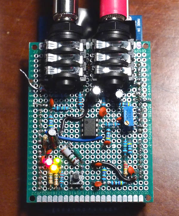

Here is what the board currently looks like:
Notice the snazzy 3 LED display with selector switch. I can switch between 8 different effects with the button and the LED's display which effect is in use.

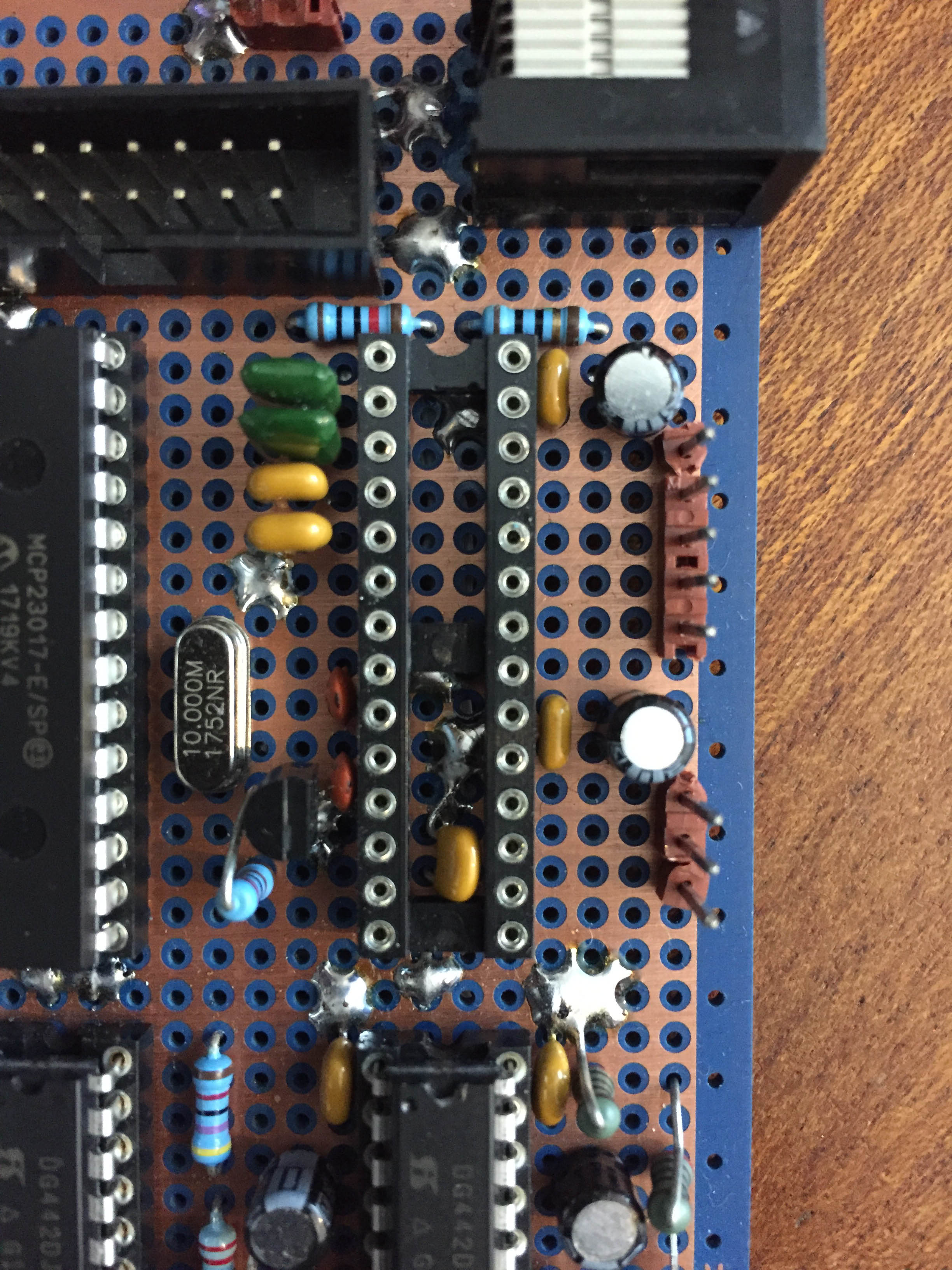

See the photo for a part of a prototype industrial controller I'm working on.
The socket is for a DSPIC33, the ground pins are directly linked to ground plane by through wires and each power pin has a ceramic as close as physically possible - the one inside the socket and two parallel to the right side. A typical IC manufacturers requirement for high frequency devices is no more than 3 - 6 mm between device pin and decoupling cap, shorter if possible.
(The two small reddish ones are the oscillator caps and the other group of four are on analog inputs - it is a mixed signal system with some complex analog functions as well as a lot of digital.)
It also has electrolytics for bulk decoupling in several places, two of the smaller ones are next to the ceramics.
For anything involving even vaguely sensitive analog or for high frequency gear I only ever use ground-plane boards. That minimises ground noise and offsets before they start to cause problems in most cases, as well as vastly reducing general noise.

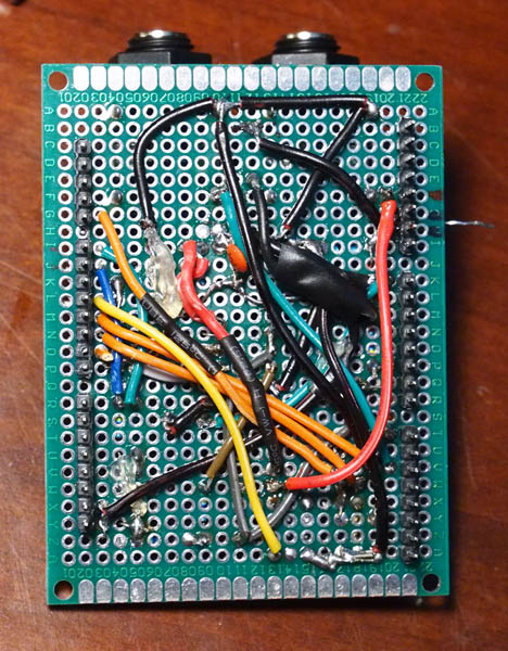

Getting them that close would be an issue with this board. (I'm using a MCU board similar to the one shown in the middle of the schematic). The MCU is surface mount with a very tight pin pitch. I might be able to piggy pack a ceremic on top of the MCU power and ground pins. Anything I put on the daughter card is going to be at least 5-6 cm away at a minimum.

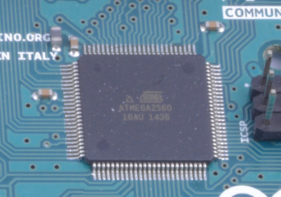

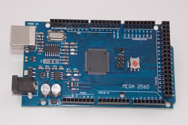

OK, looking at that - I'd try a real arduino board rather than a clone, or at least a better clone.

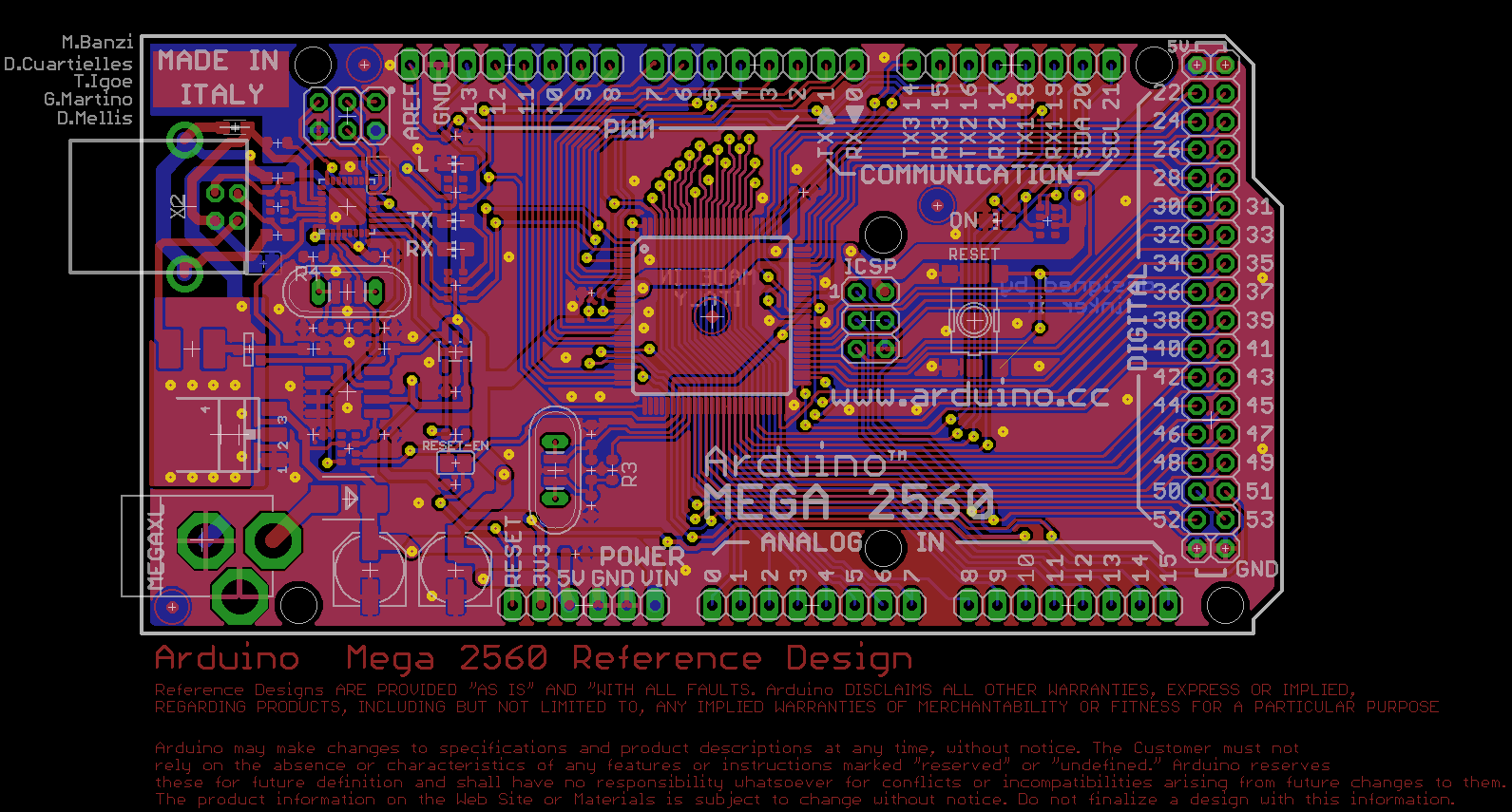

I've found a through-PCB view of what appears to be that Arduino board, in the official version. It has a large ground plane area under the CPU with a good wide power track through near the top with what looks to be provision for a ceramic cap at the left and an electrolytic just above the right side:
The lower diagonal track is also power, but has no decoupling even on the official board, from what I can see.
Those capacitors do not appear to exist on your CPU board.
Or, if your board does have any obvious ground and power copper areas below the chip, soldering some ceramics caps (different values, large and small) flat to the board and directly across those may help.

That prototyping board is a ground-plane type, sometimes referred to as having a "colander ground plane" due to the array of clearance holes around the drilled holes.
It's one of these, the top with the normal stripboard pattern on the underside. I use the square pad ones as well for some things (better for RF).
https://docs-emea.rs-online.com/webdocs/138a/0900766b8138a6e6.pdf
You can get similar ground plane board from companies like Octopad.
Edit - just examined that PCB layout a bit closer; it looks like the large copper areas are topside, underneath the CPU. You would have to look for power and ground areas close outside the IC and see if there are any spots you could add caps to. There again, your board may be very different.

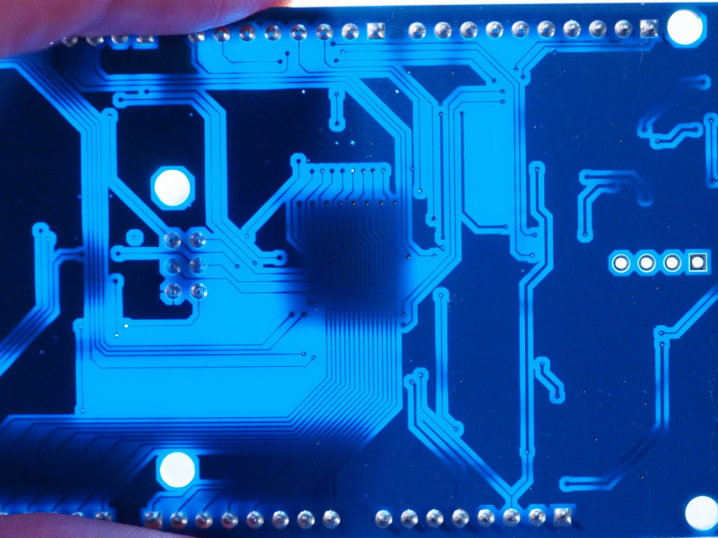

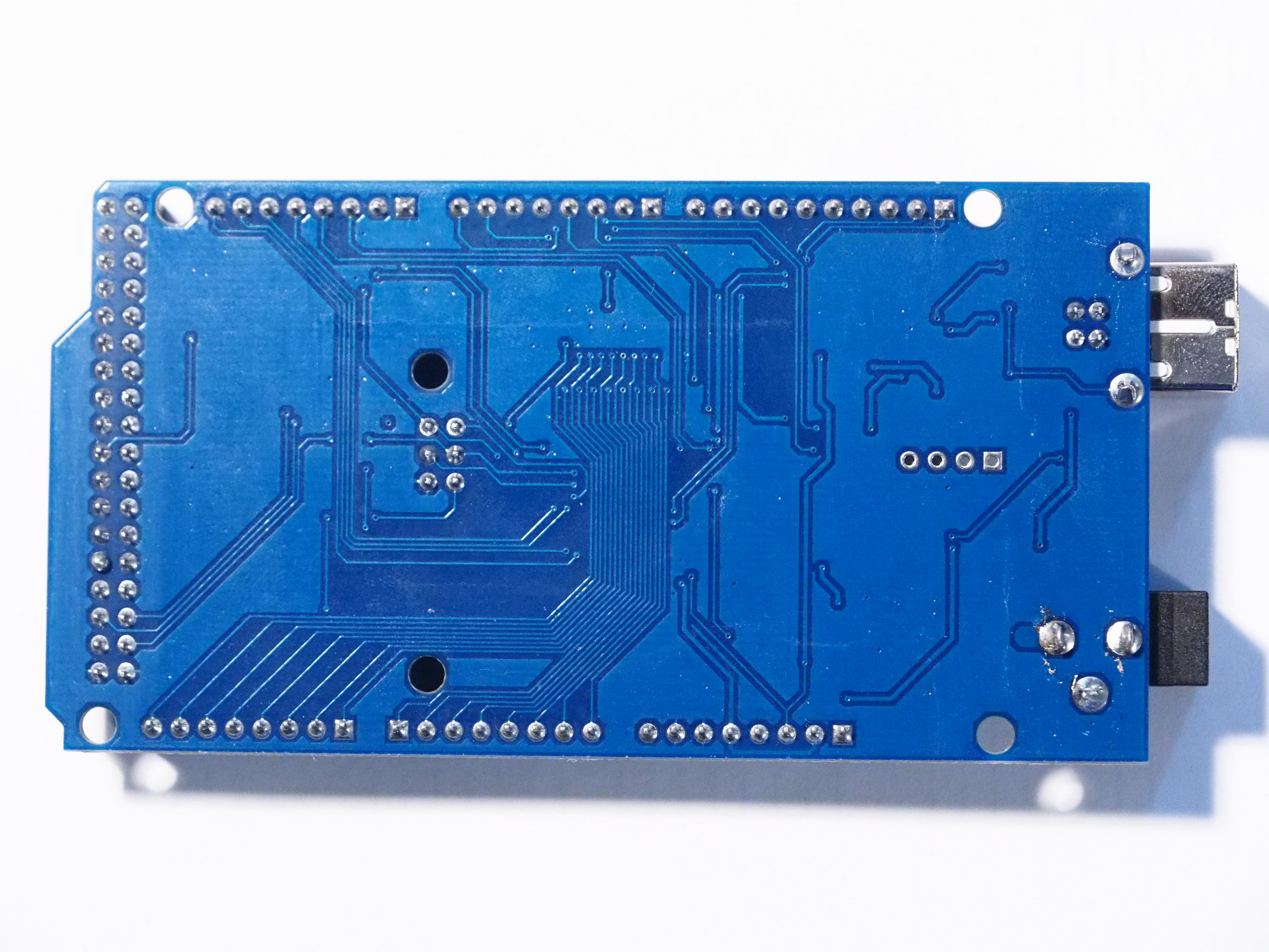

Can you post a photo of your board underside? I've found a lot of photos online that appear to be that exact board top view, but none of the back.

From this picture I found of an Genuine Arduino Mega board I can see 4 capacitors that are near the MCU. My board has none of these.
Also, my board does not have a large pad under the MCU either, on the bottom layer the Analog Input traces are running right under the MCU. I guess the board designers wanted you to be able to read all of the MCU noise on the analog inputs.
I've had good luck with some Arduino clone boards but these particular Mega clones are pretty marginal. They also have a problem resetting without a power cycle which means you have to disconnect them from USB and quickly upload them before the bootloader jumps to the main code. Reset switch doesn't work either. The ICSP port does work well but I had to trim off the pins to keep them from shorting something on my daughter board.
I guess I should have suspected something when the only brand name on these boards is "MADE IN CHINA". You would think even a Chinese company would want their company logo on the boards but not in this case, they likely wanted to not be identified.
