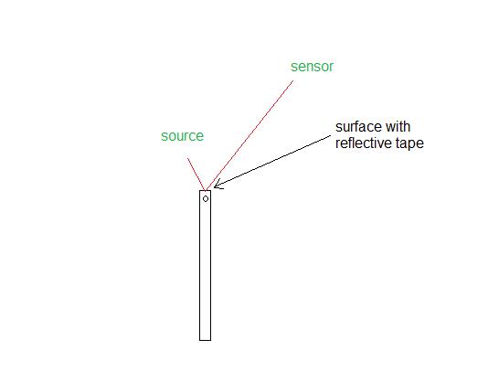

you are right, you can use the interupter with a thin object attached on the top of the pivot, you can make a hole on the object so your sensor will be inversely used, ie: it will be unblocked only at a certain point when the hole comes in line.
another way i already told you is as attached, this case you can use a reflective tape on the top of the pivot edge so it will not make any considerable error on your centre of mass.
edit: you can use 4017 counter instead of a processor to do all what you want basically.

...another way i already told you is as attached, this case you can use a reflective tape on the top of the pivot edge so it will not make any considerable error on your centre of mass...
Yes I could but that top edge will be about 4" above the pivot. I could use RV paint at that location possibly but some times the top of the pendulum is hollow. I will check into the 4017
