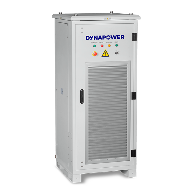

I also think it would be wise to look into designs used for the grid that do DC to AC conversion. They are already being used in some parts of the USA. I know almost nothing about these however.
Here is one link I found but have not read anything about it yet:
Not sure if that will help or not though.
