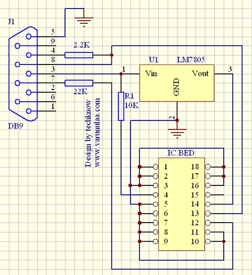

Re: Hello amady
techknow said:
Do u need the circuit diagram of my picprogrammer or the software...
all :lol:
here is ...
Amady here is the program and the circuit that i am using..it is working perfectly..so u try it and letme know...
from here you can get the software and the sys file ..if u r using windows XP or NT...If u need to view a picture of the working programmer here is the link.
