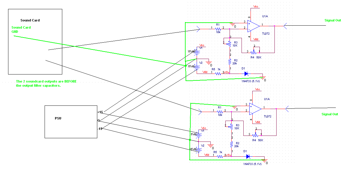

Well basically, it gets the analogue signal from a USB sound card (Before the filter capacitors) and amplifies it. What I want to know is if:
I can bypass everything behind the 1K resistor, and just feed it 5V from the USB there.
Do all the 0V grounds to to the ground on the sound card?
And where the Vdd and Vcc on the op-amp go. (If my 5V idea does work, where will they go then?)
Your opamp need a power supply in order to work
it needs a positive and a negitive rail in order to give both amplitude sides of the signal in this schematic so yor idea will not work unles you have a separate power suply for you opamp (something you want to delete in this schematic)

Hi Things,
The circuit is a dual-supply op amp inverting amplifier. Your idea will not work (at least, not without further changes) because in this configuration, the op amp requires a positive voltage (Vcc), a negative voltage (Vdd) and a ground exactly halfway between the two. Your idea would leave you with a positive supply and ground.
[Edit: Actually that's not true. It would leave you with ground and *no* positive or negative supply.]
You either need to provide a split supply as shown (which is given in your schematic by the section you want to bypass) or use a single-supply op amp configuration.
An excellent diagram by audioguru to address this issue has been posted as a sticky in General Electronics Chat.
I think you should look at another op amp besides the TL072 as well. The TL072 is spec'd only down to 7V total supply voltage. You have 5V. It will work poorly and unreliably if it works at all. Audioguru has in the past recommended the MC34071 to me, which looks good.

Hi. Well, I have found a source of + and - 15V I can use. So, would I be able to hook the +15 up to pin 8 on the opamp directly, and the - to the 1K res. directly? Or does it need the dual supply and ground inbetween?

Hi Things,
Just hook it up as if your +15 supply was the top battery in your schematic, and -15 the bottom battery.
Make sense?
Torben

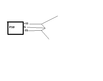

Sorry for double post, I made up a little diagram on what I thought was right, but seems like it would create a dead short?

No every ground conection will be conected to ground so that should not give a problem
although it could get funny if the ground conections are not properly conected
Yes. What you are missing is that the links between +15, gnd, and -15 in your diagram are not links in your original schematic, but batteries.
I believe what you're after is this:

I have one question: what filter capacitors? Are there filters on the outputs? What is the name of the sound card?
Anyway, I'd take the output line from the DAC (I'll call that "DAC OUT") and connect that to the input on your amplifier circuit ("AMP IN"). "Gnd" on the DAC board goes to the gnd on your amplifier circuit.

Okay, here. Basically, I have soldered wires RIGHT after the output from the little chip on the sound card.
What I want to know, is what is the "-" of the output signal.
THanks
THanks
I don't know what you mean by 'the "-" of the output signal". The output signal from your amplifier (which presumably you will hook up to some other equipment) is the output from the op amp, and gnd on the amplifier circuit will connect to gnd on whatever you hook it up to.

Morning Torben,
I believe that 'things' is asking 'where' do I connect my output ground [0v].?
You connect the Output ground [0v] to the Sound Card 0V.
