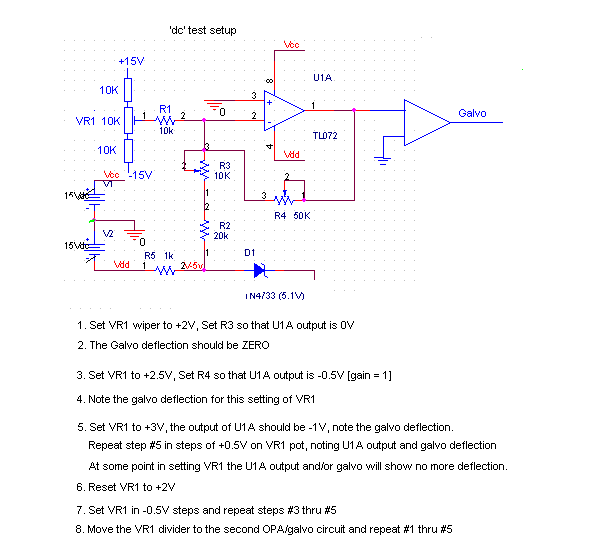

Hi, the 1K resistor is supposed to limit the voltage to like 5V right?? I measerud the voltage of the PSU, between +15V and -15V, and its like >20V !!
Does that mean: 15+15=30V ??

The 1K limits the current thru the 5V zener.
The voltage across the zener should be about -5V.
The junction of R2 and R5 should be -5.1V with respect to 0V.
Measuring from +15V to -15V should read 30V.

Do this:
Disconnect the TL072 from the sound card signal, you can leave the ground and power line as they are.
For both TL072's
Now connect R1 marked '1' to 0V
Set R4 to a value of 10K [ that will give a OPA gain of 1]
Adjust R3 until pin 1 of the TL072 reads +2V
Connect the output of the sound card [recall its got +2V sitting on it]. back onto R1
The outputs of the TL's should now be close to 0V.
Let me know what you get.

As you have no scope, we will do a quick 'dc' test of the OPA/galvo's
Look at the attached dwg.
Connect a voltage divider chain VR1 etc as shown in the dwg.
This test will check the OPA's and galvo's
Make a note and post the results of the tests.

The TL072 has two opamps inside. You are not using the second opamp and are using two dual opamps instead of just one.
Maybe the loops are the opamps oscillating.
