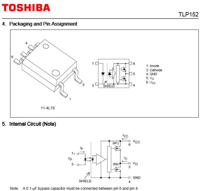

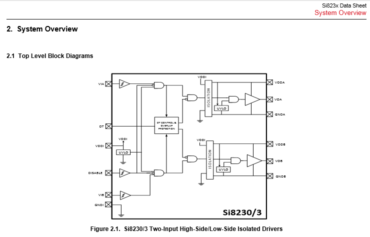

Are this mosfet drivers galvanic isolated?

SiLabs.com has many different types.

It looks like that mosfet driver already have two mosfet integrated. in schematic
The Toshiba TLP152 has a high current Cmos output and like all opto-couplers its input LED is galvanically isolated from its detector output circuit.
If it is used to drive your load instead of separate Mosfets then what is your load and what is its supply voltage?

So this mosfet drivers contain voltage generating part and control part for each mosfet? If i have in series lets say 10 mosfets and i want to turn on third one only. How should i connect this driver to it? To turn third mosfet on, I must to connect two pins to gate and source. Thats all I need. I have no clue how to do it with this driver.
Please start a new topic. This is not about "multivibrators". How to drive the Gate of a MOSFET with isolation.?
Please describe how the 10 MOSFETs will be connected. (bridge??) Include voltage and current. Why isolation?
